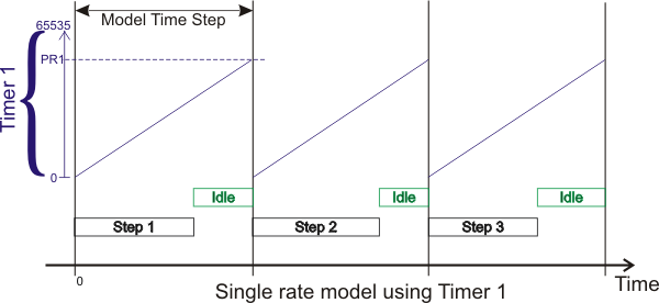

File:TimeStep SingleRateTimer1.png
Revision as of 01:23, 26 May 2008 by LubinKerhuel (talk | contribs) (Time Step reference is Timer 1. Timer 1 prescaler and PR1 register are configured so as to meet the time step set in Simulink. When Timer 1 reach PR1, it is reset and a next step is started.)
