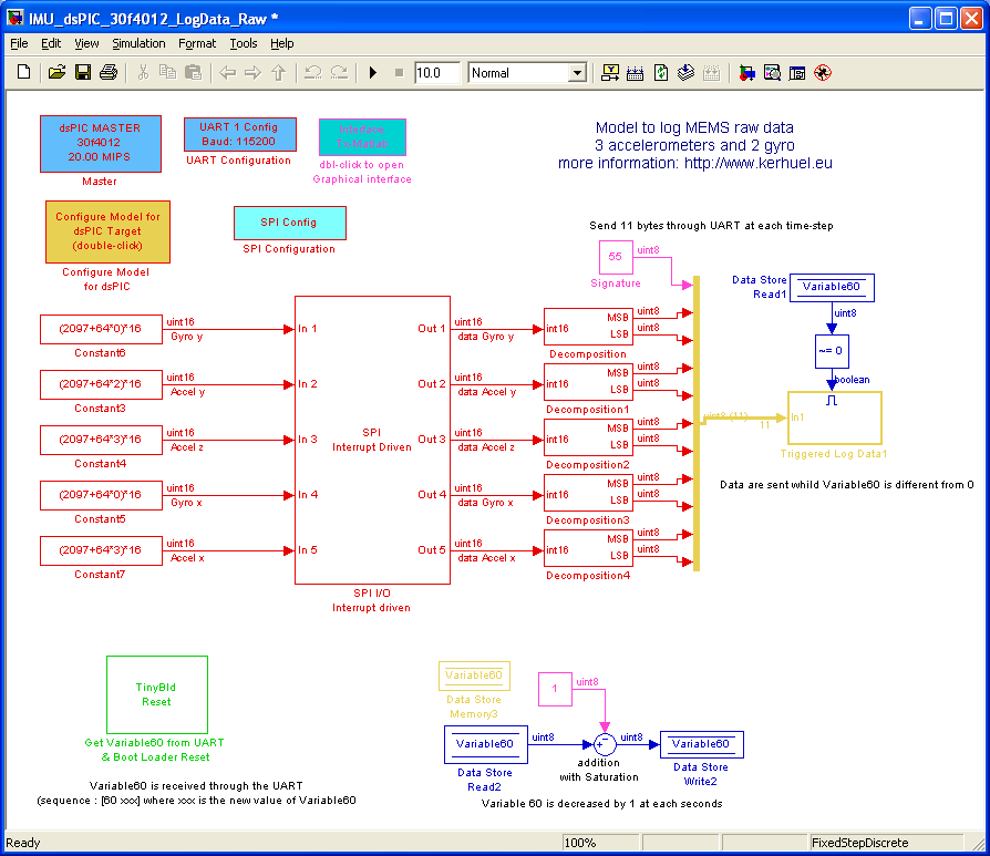

IMU_dsPIC_30f4012_LogData_Raw Simulink model: Once this model is compiled, the dsPIC (30f4012) transmit the raw values from the MEMs sensors. Data are sent to Matlab (or labview) through the UART at 115200bps with the Tx Output block. The UART buffer do not overflow with this mode, because 9 bytes are sent and the 115200bpd UART speed allow to send 11,52 bytes in one 1ms time-step. Thus all data are successfully transmitted to matlab. Logged data can feed a simulink simulation.
