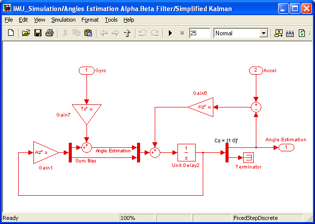

File:IMU SimplifiedKalman.png
The non adaptative Kalman filter track the rate gyro bias and estimate the angle by integrating the unbiased gyro.
current | 14:04, 12 July 2008 | ![]() | 623 × 444 (18 KB) | LubinKerhuel (talk | contribs) | The non adaptative Kalman filter track the rate gyro bias and estimate the angle by integrating the unbiased gyro. |
