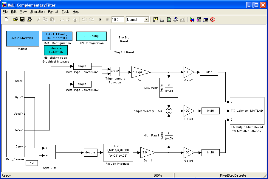

The IMU_ComplementaryFilter simulink model is a 'copy-past' mixture made of the IMU_LogData 'data management' part with the IMU_simu_RealData model tuned and optimize filter. This model implement the complementary filter on the dsPIC and send the result to matlab. It will have the same behavious of the simulated filter.
