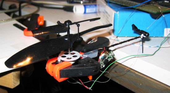

The main motor with the rotor was used for the experiments

Test Bench. The helicopter is fixed; the explorer 16 board can be seen in the right-up corner.
