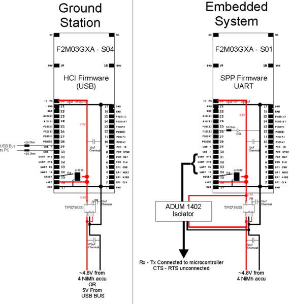

Revision as of 01:42, 14 January 2009 by LubinKerhuel (talk | contribs) (Normal 0 21 false false false FR X-NONE X-NONE MicrosoftInternetExplorer4 Electronic schematic of the two free2move Bluetooth module. The left is the F2M03GXA-S03 (USB ver)

Electronic schematic of the two free2move Bluetooth module. The left is the F2M03GXA-S03 (USB version). Connected through USB to a computer, it is used as a long range USB Bluetooth dongle able to communicate with the second Bluetooth module. The left schematic is the embedded module: F2M03GXA-S01 (UART version). It is connected to the dsPIC microcontroller through UART. When both modules are paired, a virtual COM port is created on the computer allowing transmit/receive data from the embedded system.
