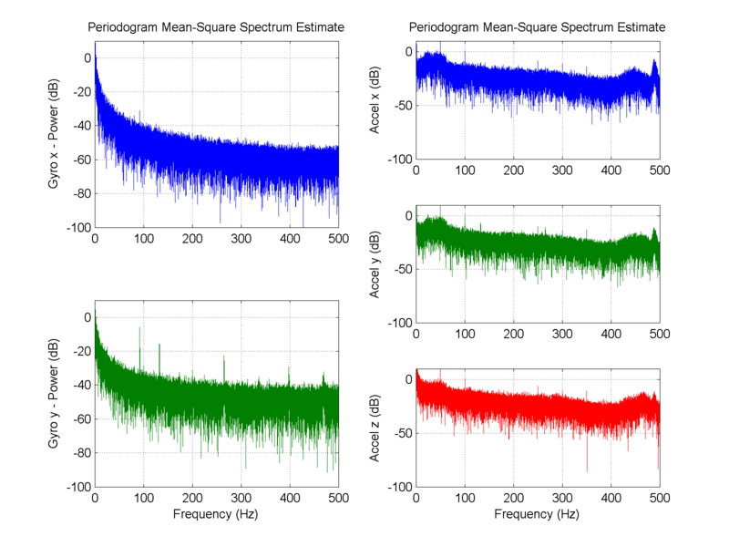

Spectral Analysis of the Raw data from Simulink_Dynamic_Calibration3.mat. The IMU box were rotated by 90 degrees with interval of about 5s. The y-Gyro is perturbed by several high frequency peak starting at 92Hz. This may due to a soldering problem. Theses high frequency peak have no influence on the angle estimation.
