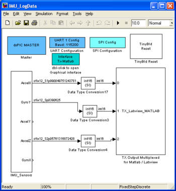

Log real data
LogData Simulink model : Once this model is compiled, the PIC (30f3012) transmit the values from the X and Y axis of the accelerometer, and the Y axis of the rate gyro. Data are sent directly to Matlab (or labview) through the UART at 115200bps thanks to the Tx_Labview_Matlab bloc.
The model IMU_LogData is compiled and the resulting .hex file is charged into the dsPIC (using the boot loader tinybld).
The quartz and PLL of the dsPIC are choosen in order to have an low UART %error when UART is configured at 115200bps, the max baud rate available on most PC. The model sample rate is 1Khz, corresponding to a time-step of 1ms. During 1ms, the UART can send 11 Bytes when configured at 115200 bps (including start and stop bits).We log 3 X (int16) data (X and Z acceleration ; and Y raw gyro). Adding one protocol byte for each variable sent, the model send 9 bytes at each time step. Because the model send less that 11 data by time-step, all data will be sent and logged by the PC. Note that if the model send more that 11 bytes, some data would be lost (it is OK for visual checking but not for use as input data into in a simulation).
The data that get out from the IMU_Sensors block are fixed point data type. They are transformed into uint16 using the Store Integer method : in other word, their bits are not modified, but their representation for simulink is now uint16 (thus, their value has changed for simulink !) . They can be sent by the TxOutputMultiplexed block that is able to send int8, uint8, int16, uint16, int32 or uint32 data type.
The dsPIC is connected to the PC COM port (with the Max232 component for level translation, or equivalent) and data are logged using the graphical interface (open the Interface TxMatlab block, for more information, see examples). The following lines are typed at the maltab prompt to save data into a .mat file :
>> [R T] = padr(Rn,1,t_Rn);
>> AxelX_GyroY_AxelZ = [T R]';
>> AxelX_GyroY_AxelZ(1,:) = [0:33332]*1e-3;
>> save AxelX_GyroY_AxelZ3 AxelX_GyroY_AxelZ;
padr is a command from the blockset. It allow to remove the NaN from the Rn matrix. The resulting R matrix is transposed and time is added in its first line. The time T which is a modified copy of t_Rn is not accurate since it is estimated by the time at which values are received. We know that the data are sent at a 1Khz frequency so we can redifine the time of the AxelX_GyroY_AxelZ matrix before saving it into the AxelX_GyroY_AxelZ3.mat file.

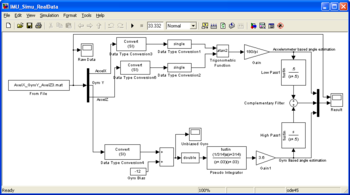

Simulation based on real data
The IMU_simu_RealData simulink model simulate the complementary filter using the real data previously logged with the dsPIC. Many filters can be tested using the same real data. The frequency of the filter and bias values can be tuned to get the best result (with the logged data)
The model IMU_Simu_RealData uses the logged data contained in the file AxelX_GyroY_AxelZ3.mat. Theses data are used to design a simple complementary filter and simulate it. Because we are using real data, the input of the simulation has precisely the right properties (noise, bias...). The filter can be design and simulated with data that are close to reality.
In this model, datas are converted back into their former fixed point representation data type. In other word, their binary data is not modified, but the scaling is modified. After the first conversion block, they are equivalent to the data of the IMU_sensors block of the previous model.
Data are converted again into double or single to simplify the design at this step. The upper part of the model estimates the Y axis angle computing the atan of the X and Z accelerometers values. Because we use the Atan function, the two accelerometer axis do not need to be scaled. The only constraint is that the X and Z acceleration share the same scaling.
The lower part of the model estimate the Y axis angle integrating the Y rate gyro. The dynamic of the gyro (low pass filter) is compensated for. The rate gyro is also high pass filtered to remove most of the DC part.
The complementary filter, two first order filter (high pass and low pass) with cut off frequency at 0,08Hz. The final estimation of the angle is the addition of the resulting values from theses two filters. The result is presented in pink on the lower part of the following figure.
Top curves : The X (yellow) and Z (cyan) accelerometers raw data with the Y axis rate gyro (pink). The y scale is the raw numerical value as read from the Gyro-SPI bus. The x scale is time (simulation duration is 33,32s). The three bottom curves are the simulated estimation of the angle (Y axis) using three different methods. The yellow curve is the estimated angle from the X and Z accelerometers, sensing the gravity. The cyan curve is the estimated angle, integrated from the Y rate gyro. The pink curve is the estimated angle estimated with the complementary filter that fusion the relevant informations from both the Y rate gyro and the X-Z accelerometer
