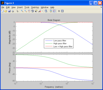

Complementary Filter
1st order
A complementary filter combines the two estimations. High frequency part of the angle estimated from the rate gyro is added to the low frequency part of the angle estimated with the accelerometer. Thus, the low drift of the estimated angle from the gyro is filtered and only high frequency estimated angle from the gyro is used. The low frequency part of the angle estimated rely on the angle estimated using the accelerometer. The high frequency of the angle is estimated with the gyro which provide a fast and accurate information but which cannot be integrated due to the accumulation of the bias error.
- The 0.8Hz first order low pass filter transfer function for the accelerometer is :
<Tex>Lp(s) = \frac{0.5}{s+0.5}</Tex>
- The 0.8Hz first order High pass filter transfer function for the rate gyro is :
<Tex>Hp(s) = \frac{s}{s+0.5}</Tex>
- From the analog device datasheet, the rate gyro has a cut off frequency at 40Hz. Thus, the transfer function of the integration of the rate gyro including the inverse dynamic of the rate gyro is:
<Tex>Int(s) = \frac{1}{314} * \frac{s+314}{s}</Tex>
- For the rate gyro, we obtain the simplification :
<Tex>Hp(s) * Int(s) = \frac{s}{s+0.5} * \frac{1}{314} * \frac{s+314}{s} = \frac{1}{314} * \frac{s+314}{s+0.5}</Tex>
The upper part of the complementary filter block estimates the Y axis angle computing the arctan of the X and Z accelerometers values. The lower part of the complementary filter blocks estimates the Y axis angle integrating the Y rate gyro. The dynamic of the gyro (low pass filter) is compensated for. The rate gyro is also high pass filtered to remove most of the DC part. The complementary filter, two first order filter (high pass and low pass) with cut off frequency at 0,08Hz. The final estimation of the angle is the addition of the resulting values from theses two filters.
This first order complementary filter gives correct results. However, the gyro bias which is integrated generate a ramp. The order 1 filter output has a steady state error while estimating the gyro static value due to this ramp. An order 2 filter is however capable to remove this steady state error.
