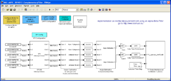

The model '''IMU_Simulation.mdl''' uses the logged data stored in .mat files. These data are used to design and simulate IMU algorithms. Using real data, the input of the simulation has the correct properties (noise, bias, nonlinearity...). The data stored are exactly the same data read at the output of sensors. Once the simulation provide correct results, the tuned algorithm is implemented as is (from simulink) directly in the microcontroller (PIC/dsPIC).
One Gyro supply the 2.5V alimentation to the accelerometer. The two gyro convert the three analog values of X,Y, and Z of the accelerometer. The IMU transfer the 5 data to the microcontroler through the SPI bus.
The raw data feeds the Sensor Calibration block. This block removes bias of rate gyro and accelerometers. Because we use the arctan function, the accelerometer axes do not need scaling. Only rate gyro measurements are scaled.

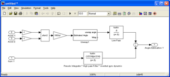

[[Image:IMU_Simulation_ComplementaryFilter.png|thumb|right|350px|Complementary Filter for IMU angle estimation]]
The aim of this complementary filter is to provide a method to implement a model on the dsPIC that has been previously improved thanks to the use of the simulation capabilities of simulink. Simulation uses real data logged by the dsPIC peripheral (same electronic circuit, same noise etc...)
A complementary filter combines the angle estimations from both the rate gyro and the accelerometers. High frequency part of the angle estimated from the rate gyro is added to the low frequency part of the angle estimated with the accelerometers. Thus, the low drift of the estimated angle from the gyro is filtered out and only the high frequency part of the rate gyro estimated angle is retained. The low (or DC) frequency part of the angle estimated rely on the accelerometers angle estimation.
In a first step, the real data are logged by the IMU_LogData. The complementary filter is simulated using the real data in the IMU_simu_RealData. The resulting model is then implemented into the dsPIC in the IMU_ComplementaryFilter model.

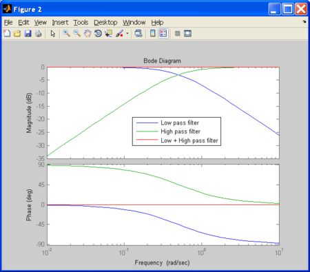

* The 0.08Hz first order low pass filter transfer function for the accelerometer is :
<math>Lp(s) = \frac{0.5}{s+0.5}</math>
[[Image:IMU_LogDataModel.png|thumb|right|350px|LogData Simulink model : Once this model is compiled, the PIC (30f3012) transmit the values from the X and Y axis of the accelerometer, and the Y axis of the rate gyro. Data are sent directly to Matlab (or labview) through the UART at 115200bps thanks to the Tx_Labview_Matlab bloc.]]
* The 0.08Hz first order High pass filter transfer function for the rate gyro is :
<math>Hp(s) = \frac{s}{s+0.5}</math>
The model IMU_LogData is compiled and the resulting .hex file is charged into the dsPIC (using the boot loader tinybld).
[[Image:Bode_1stOrderComplementaryFilter.png|thumb|center|450px|Bode diagram of a 0.08Hz 1st order complementary filter. The blue curve is the low pass filter. The green curve is the high pass filter and the red curve is the addition of both filters. The red curve has a phase of 0° and a gain of 1.]]

[[Image:IMU_dsPIC_30f4012_ComplementaryFilter_20Mips.png|thumb|right|350px|This model implements the complementary filter on the dsPIC and sends the result to matlab. It has the same behaviours as the simulated filter.]]
To design the filter for the dsPIC, the two precedent models are mixed up. The filter is inserted by copy-past into the first model used to log data.
Data logged in real time from the complementary filter implemented on the dsPIC (30f4012 running at 10MHz). X axis: time in second. Y axis: angle multiplied by 100 (see model).
The blue curve is the estimated angle from the X and Z accelerometers, resolving the gravity vector. The red curve is the estimated angle integrated from the Y rate gyro. The green curve is the angle estimated through the complementary filter that fusion the relevant information from both the Y axis rate gyro and the X and Z accelerometers.
The estimated angle using accelerometers (blue curve) is quite noisy. However, its steady value is correct. The estimated angle relying on the integration of the gyro is clean but drift (red curve). Note that the dsPIC has just been switch on and the High pass filter of the pseudo integrator of the gyro has not yet removed the remaining DC bias of the gyro. The DC bias of the Gyro has probably changed due to non constant temperature. Thus, the integrated angle drifts slowly from its real value. The green curves that use both data is clean and drift free. Its dynamics is as fast as the gyro dynamic. Note that at the beginning, the High pass filter (with a higher bandwidth than the gyro pseudo-integrator high pass filter) has not yet removed the gyro bias. However, at the end of the animation (11 seconds long: from 3, 5 to 14, 5), both curves (blue and green) are merging as in the simulation.
  • The 0.08Hz first order low pass filter transfer function for the accelerometer is :
[math]Lp(s) = \frac{0.5}{s+0.5}[/math]
  • The 0.08Hz first order High pass filter transfer function for the rate gyro is :
[math]Hp(s) = \frac{s}{s+0.5}[/math]
  • From the analog device datasheet, the rate gyro has a cut off frequency at 40Hz. Thus, the transfer function of the integration of the rate gyro including the inverse dynamic of the rate gyro is:
[math]Int(s) = \frac{1}{314} * \frac{s+314}{s}[/math]
  • For the rate gyro, we obtain the simplification :
[math]Hp(s) * Int(s) = \frac{s}{s+0.5} * \frac{1}{314} * \frac{s+314}{s} = \frac{1}{314} * \frac{s+314}{s+0.5}[/math]
The upper part of the complementary filter block estimates the Y axis angle computing the arctan of the X and Z accelerometers values. The lower part of the complementary filter blocks estimates the Y axis angle integrating the Y rate gyro. The dynamic of the gyro (low pass filter) is compensated for. The rate gyro is also high pass filtered to remove most of the DC part. The complementary filter, two first order filter (high pass and low pass) with cut off frequency at 0,08Hz. The final estimation of the angle is the addition of the resulting values from theses two filters.
This first order complementary filter gives fairly good results. However, the integrated rate gyro bias generates a ramp. The 1st order filter has a small steady state error while filtering the integrated rate gyro due to this ramp. An order 2 filter is however capable to remove this steady state error.
To design the filter for the dsPIC, the two precedent models are mixed up. The filter is inserted by copy-past into the first model used to log data. Data logged in real time from the complementary filter implemented on the dsPIC (30f4012 running at 10MHz). X axis: time in second. Y axis: angle multiplied by 100 (see model). The blue curve is the estimated angle from the X and Z accelerometers, resolving the gravity vector. The red curve is the estimated angle integrated from the Y rate gyro. The green curve is the angle estimated through the complementary filter that fusion the relevant information from both the Y axis rate gyro and the X and Z accelerometers.
The IMU_ComplementaryFilter simulink model is a 'copy-past' mixture made of the IMU_LogData 'data management' part with the IMU_simu_RealData model tuned and optimize filter. This model implements the complementary filter on the dsPIC and sends the result to matlab. It will have the same behaviours of the simulated filter.
