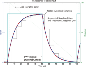

[[Image:HyperSampling_Results.png|thumb|right|500px|HyperSampling results. Light blue line is the reconstructed PWM signal generated by the Output Compare peripheral. The deep blue line is the sampled data that superpose perfectly with calculated RC response plotted (red dashed line). The black thin line shows the reconstructed result of the ADC output when use at its fastest sampling rate (without hyper sampling technique).]]
[[Image:HyperSampling_Results.png|thumb|right|350px|HyperSampling results. Light blue line is the reconstructed PWM signal generated by the Output Compare peripheral. The deep blue line is the sampled data that superpose perfectly with calculated RC response plotted (red dashed line). The black thin line shows the reconstructed result of the ADC output when use at its fastest sampling rate (without hyper sampling technique).]]
The figure with the result show the reconstructed PWM signal (which was not logged!). The predicted response of the RC filter is plotted in red dashed line. The sampled result is plotted in deep blue. The black line is a reconstruction of the fastest sampling time of the PIC32 using classical method. The ADC sampling delay line is the value of the Sampling Offset within PWM (see Simulink file)
