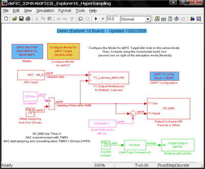

Simulink model file
Simulink model file used to programme the PIC32 chip. The ADC and Output Compare HW block are synchronised via the use of Timer 3. Data are sent and logged with matlab via UART.
The ADC block is set to synchronise the ADC sampling time with Timer 3 end of Period. This timer 3 is used to generate the PWM signal (see Output Compare HW block). The PWM signal is shifted at each simulink time step by an amount of 10ns (block Offset Sampling from 0 to OCmax). Thus, the ADC sampling time, which occurs at the end of the timer 3 period is virtually shifted within the generated PWM output signal.
