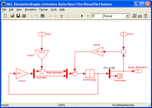

Non adaptative Kalman Filter
The non adaptative Kalman Filter (Also called Alpha Beta Filter) track the gyro bias using information from the accelerometers, then estimate the angle by integrating the unbiased gyro.
