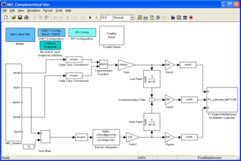

The model IMU_Simu_RealData uses the logged data contained in the file AxelX_GyroY_AxelZ3.mat. Theses data are used to design a simple complementary filter and simulate it. Because we are using real data, the input of the simulation has precisely the right properties (noise, bias...). The filter can be design and simulated with data that are close to reality.
In this model, datas are converted back into their former fixed point representation data type. In other word, their binary data is not modified, but the scaling is modified. After the first conversion block, they are equivalent to the data of the IMU_sensors block of the previous model.
Data are converted again into double or single to simplify the design at this step. The upper part of the model estimates the Y axis angle computing the atan of the X and Z accelerometers values. Because we use the Atan function, the two accelerometer axis do not need to be scaled. The only constraint is that the X and Z acceleration share the same scaling.
The lower part of the model estimate the Y axis angle integrating the Y rate gyro. The dynamic of the gyro (low pass filter) is compensated for. The rate gyro is also high pass filtered to remove most of the DC part.
The complementary filter, two first order filter (high pass and low pass) with cut off frequency at 0,08Hz. The final estimation of the angle is the addition of the resulting values from theses two filters. The result is presented in pink on the lower part of the following figure.
To design the filter for the dsPIC, the two precedent models are mixed up. The filter is inserted by copy-past into the first model used to log data.
Logging dara resulting from this filter running on the dsPIC, we get the following curves :
Data logged in real time from the complementary filter implemented on the dsPIC (30f4012 running at 10MHz). X axis : time in second. Y axis : angle multiplied by 100 (see model) The blue curve is the estimated angle from the X and Z accelerometers, resolving the gravity vector. The red curve is the estimated angle integrated from the Y rate gyro. The green curve is the angle estimated through the complementary filter that fusion the relevant informations from both the Y axis rate gyro and the X and Z accelerometers.
The estimated angle using accelerometers (blue curve) is quite noisy. However, it steady value is correct. The estimated angle relying on the integration of the gyro is clean but drift (red curve). Note that the dsPIC has just been switch on and the High pass filter of the pseudo integrator of the gyro has not yet removed the remaining DC bias of the gyro. The DC biais of the Gyro has probably change due to non constant temperature in my house. (I do not have a clim in my tiny room which is in a roof in Marseille ! ). Thus, the gyro integrated angle is slowing drifting away from its real value. The green curve that use both data is clean and driftfree. Its dynamics is as fast as the gyro dynamic. Note that at the beginning, the High pass filter (with a higher bandwidth than the gyro pseudo-integrator high pass filter) has not yet removed the gyro bias. However, at the end of the animation(11 secondes long: from 3,5 to 14,5), both curves (blue and green) are merging as in the simulation.
