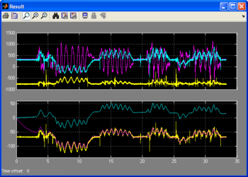

[[Image:IMU_simu_RealData_Curves.jpg|thumb|right|350px|Top curves : The X (yellow) and Z (cyan) accelerometers raw data with the Y axis rate gyro (pink). The y scale is the raw numerical value as read from the Gyro-SPI bus. The x scale is time (simulation duration is 33,32s).
[[Image:IMU_simu_RealData_Curves.png|thumb|right|350px|Top curves : The X (yellow) and Z (cyan) accelerometers raw data with the Y axis rate gyro (pink). The y scale is the raw numerical value as read from the Gyro-SPI bus. The x scale is time (simulation duration is 33,32s).
The three bottom curves are the simulated estimation of the angle (Y axis) using three different methods. The yellow curve is the estimated angle from the X and Z accelerometers, sensing the gravity. The cyan curve is the estimated angle, integrated from the Y rate gyro. The pink curve is the estimated angle estimated with the complementary filter that fusion the relevant informations from both the Y rate gyro and the X-Z accelerometer]]

The IMU_simu_RealData simulink model simulate the complementary filter using the real data previously logged with the dsPIC. Many filters can be tested using the same real data. The frequency of the filter and bias values can be tuned to get the best result (with the logged data)
Data are converted again into double or single to simplify the design at this step. The upper part of the model estimates the Y axis angle computing the atan of the X and Z accelerometers values. Because we use the Atan function, the two accelerometer axis do not need to be scaled. The only constraint is that the X and Z acceleration share the same scaling.
The lower part of the model estimate the Y axis angle integrating the Y rate gyro. The dynamic of the gyro (low pass filter) is compensated for. The rate gyro is also high pass filtered to remove most of the DC part.
The complementary filter, two first order filter (high pass and low pass) with cut off frequency at 0,08Hz. The final estimation of the angle is the addition of the resulting values from theses two filters. The result is presented in pink on the lower part of the following figure.
Top curves : The X (yellow) and Z (cyan) accelerometers raw data with the Y axis rate gyro (pink). The y scale is the raw numerical value as read from the Gyro-SPI bus. The x scale is time (simulation duration is 33,32s). The three bottom curves are the simulated estimation of the angle (Y axis) using three different methods. The yellow curve is the estimated angle from the X and Z accelerometers, sensing the gravity. The cyan curve is the estimated angle, integrated from the Y rate gyro. The pink curve is the estimated angle estimated with the complementary filter that fusion the relevant informations from both the Y rate gyro and the X-Z accelerometer
