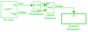

===Bootloader RESET=== | ===Bootloader RESET=== | ||
| + | [[Image:SimulinkModel_BootloaderResetSubsystem.png|thumb|left|300px|Bootloader Reset subsystem. The subsystem read one value received on the UART. If it receive the value 55, another subsystem is enabled. This subsystem will block the step until a character 66 is received on the UART, causing a reset of the chip (see subsystems).]] | ||
Both models use UART to exchange data with the PC. The block [[Block/UART_Configuration|UART configuration] set-up the dsPIC UART1 peripheral on Alt Tx/Rx pins with a bauds rate of 115200. dsPIC A does not send result to the PC, but use however the UART for the bootloader. The subsystem Bootloader RESET (tinybld) read the received data on the UART. If the value 55 is received, the subsystem will wait forever (and thus stop the real time computation of the model steps), until the value 66 is received on the UART. The dsPIC is then reset. Thus, from the PC tinybld bootloader application (tinybldWin.exe), the values 55 and 66 are sent first to reset the dsPIC (theses reset code are set up in the Option tab, in Codes to sent first). | Both models use UART to exchange data with the PC. The block [[Block/UART_Configuration|UART configuration] set-up the dsPIC UART1 peripheral on Alt Tx/Rx pins with a bauds rate of 115200. dsPIC A does not send result to the PC, but use however the UART for the bootloader. The subsystem Bootloader RESET (tinybld) read the received data on the UART. If the value 55 is received, the subsystem will wait forever (and thus stop the real time computation of the model steps), until the value 66 is received on the UART. The dsPIC is then reset. Thus, from the PC tinybld bootloader application (tinybldWin.exe), the values 55 and 66 are sent first to reset the dsPIC (theses reset code are set up in the Option tab, in Codes to sent first). | ||
Value 55 will stop the dsPIC (and will prevent the dsPIC from using its UART anymore). Then value 66 reset the dsPIC which will enter into its embedded bootloader code. Then the PC bootloader and the dsPIC bootloader application should see each other.
