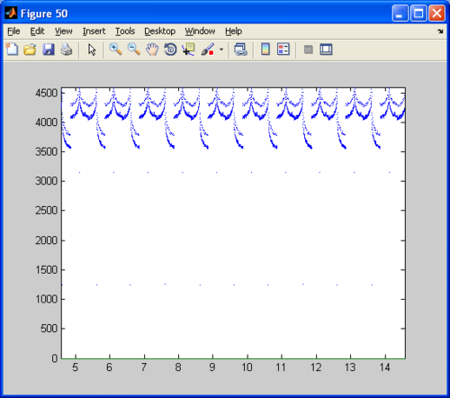

Time Step. From the Master block, the 2ms time step correspond to a value of 18399. Real time constraints are respected.
The max time step recorded for this model is about 4500. With the same scale, the model time step configuration corresponds to 18399. Thus, the dsPIC is used at 25%
[math]\frac{4500}{18399} = 0.25[/math]
It is quite time consuming but this model could be optimized. Generation of the sinus should be done using a look up table (from the simulink standard library) and all calculation should be done using only fixed step variable (no double !)
