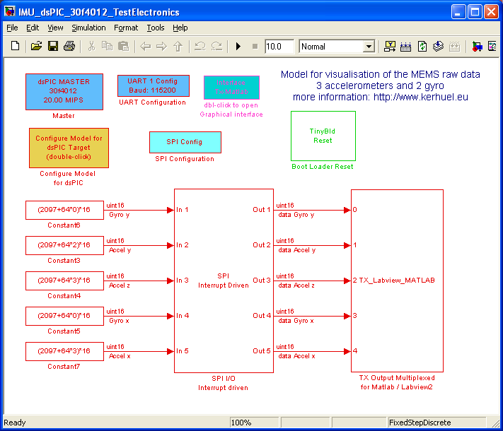

IMU_dsPIC_30f4012_TestElectronics Simulink model: Once this model is compiled, the dsPIC (30f4012) transmit the values from the X, Y and Z axis of the accelerometer, and the Y and X axis of the rate gyro. Data are sent to Matlab (or labview) through the UART at 115200bps with the Tx Output Multiplexed for Matlab-Labview block. All data cannot be send ; there will be missing data thus this model is usefull to check every component is working only.
