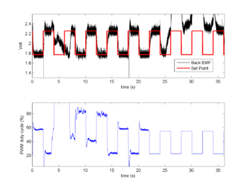

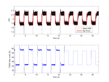

[[Image:Picooz_SensorlessSpeedControl_OpenVsCloseLoop_Perturbation.png|thumb|right|350px|From time 0 to time 22, the speed controller is activated: the PWM duty cycle (bottom blue line) is controlled with a feedback state space model. I tryed to slow down the rotor with my finger, but as it can be seen, the PWM duty cycle rise to compensate for the perturbation. From 22s until the end (about 40s) the speed controller in not activated and the PWM duty cycle controlling the robot is set in open loop. This time, when I disturbe the motor, the systeme do not compensate thus the motor just slow down, making the back EMF measurement getting higher.]] | [[Image:Picooz_SensorlessSpeedControl_OpenVsCloseLoop_Perturbation.png|thumb|right|350px|From time 0 to time 22, the speed controller is activated: the PWM duty cycle (bottom blue line) is controlled with a feedback state space model. I tryed to slow down the rotor with my finger, but as it can be seen, the PWM duty cycle rise to compensate for the perturbation. From 22s until the end (about 40s) the speed controller in not activated and the PWM duty cycle controlling the robot is set in open loop. This time, when I disturbe the motor, the systeme do not compensate thus the motor just slow down, making the back EMF measurement getting higher.]] | ||

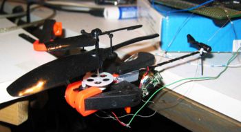

+ | [[Image:Picooz_SensorlessSpeedControl_TestBench.jpg|thumb|right|350px|Test Bench. The helicopter is fixed, the explorer 16 board can be seen in the right-up corner.]] | ||

I did not build a complete embedded electronic system for the PICOOZ. This is a demo example is based on the Explorer 16 board, using the PIC32MX460F512L gracefully provided by Microchip. Converting the code for others dsPIC (30f, 33F, 24h) is quite straight using the Simulink blockset. Thus, the Picooz is taken as a test bench for the design of a sensorless speed controller. i.e. The helicopter will not flight in theses tests.

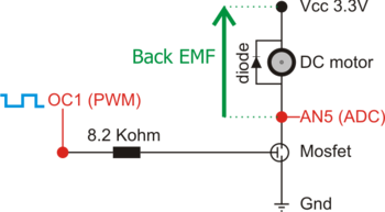

One tiny electronics board composed of three components (see image) is connected to the Explorer 16 board. This tiny board allows to provide energy power suply to the motor. The motor power suply is controlled through a PWM duty cycle from the microcontroller allowing to controll the voltage given to the motor. The MOSFET transistor: FDC6305N act as a high speed switch. When passing, its internal resistor is only of 0.1 Ohms. This small resistor has small impact on the max speed. It also make the MOSFET to keep low temperature. The resistor between the Microcontroller OC1 pin (PWM) and the MOSFET protects the microcontroller. The diode in parallel with the DC motor limits the nasty glitch due to the PWM signal passihg through the motor coil. This dode is very important to protect the microcontroller. Removing this diode may severly damage the ADC of the microcontroller, of the entire microcontroller.

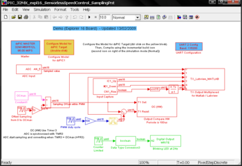

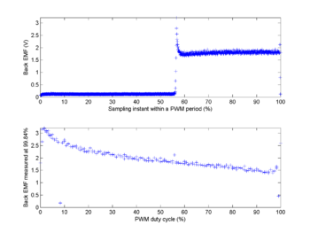

A first simulink model programs the microcontroller so as to set-up the back-EMF measurement. This first model increase linearly the PWM motor duty cycle (from 0 to 11999 with atep size of 100) increasing the PICOOZ rotor's speed rate. There is no feed-back in this first experiment. For each 119 different duty cycle, the ADC channel 5 is sempled at 1200 different places within the PWM period. Thus, we obtain a 2D matrix, with the back EMF measurement (ADC conversion on AN5) in function of both
- The Sampling position within PWM period
- The PWM duty cycle
Theses measurement allows to determine the best place within the PWM period to measure the back EMF, and also alows to see the Back EMF evolution in function of the PWM duty cycle (i.e. in function of the motor speed rate).

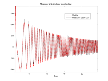

Identification of the dynamic of the Picooz's main rotor
The design of a controller requires a model. A second simulink model programs the microcontroller to test the dynamic response of the motor. The Back EMF is there always sampled at the instant 11970 (we takes some safety margin). The PWM duty cycle is now a chirp signal (sinus with increasing frequency) that makes the motor to accelerate and to slow down at increasing frequency. We supposed that the Back-EMF is an image of the moto speed rate. Thus, the motor model is identified using the matlab ident graphical user interface.
We get a two poles model for the Back-EMF (i.e. for the motor's dynamic)
<Tex>G_{motor}(p) = \frac{-24.62}{(p+78.65)(s+9.78)}</Tex>
The time constant of the motor <Tex>\tau_{OpenLoop} = 102ms </Tex> is calculated from the slower pole. Let's now design a close-loop controller to improve the motor's response and capacity to reject perturbation (due to gust of wind or to battery power decrease)

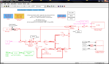

Controller design
The controller is designed keeping with theses two constraintes :
- The implementation of the PWM output on the OC1 pin is quite sensitive to noisy set point (see blocks page). Thus, the controller command signal should have a reduced noise level.
- The continuous decrease of the battery level act as a continuous perturbation on the controller. Thus, rejecting with no steady states error this perturbation requires at least one integrator within the controller loop.
I decided to use an augmented state space model. A state space model has the advantage over a PID or PI only system to filter the output thanks to the internal model. The augmented stats is the integral of the error, providing thus a controller with no steady state error.
We use the matlab new command lqi (available from Matlab 2008b) to compute the matrix gain K. The observer gain L is computed so as to get an observer pole as slow as the slowest pole of the close loop control system. Such a low gain allow to filter efficiently noise comming from the PWM measurement.
Ts = .002; % Controller Sample time Picooz_Mrotor = zpk([],[-78.68 -9.787],-24.6222); Picooz_Mrotor_z = c2d(Picooz_Mrotor,Ts,'zoh'); [Picooz_Mrotor_z_ss,T] = canon(Picooz_Mrotor_z,'modal'); % transformation pour calculs plus simple x ==> T*x [Az,Bz,Cz,Dz,Te] = ssdata(Picooz_Mrotor_z_ss); [m,n] = size(Az); %% Augmented state space synthesis (K) R = 1; Q = diag([1 1 2e6]); [K,Z,e] = lqi(Picooz_Mrotor_z_ss,Q,R,0); %Poles en continue : log(eig(Az))/Ts % System Natural Poles log(e)/Ts % Poles in close loop PolesControlleur_s = log(e)/Ts ; %% Observer L Synthesis poleLent = abs(PolesControlleur_s(1:end-1)) PlacementPolesObs = exp(-poleLent * Ts * 1 ); %*3 usually L = acker(Az',Cz',PlacementPolesObs'); %% Simplification % Az is diagonal (thanks to the cannon command) Az = diag(Az)';
We get results for L and K : L = [-0.0593 0.826] and K = [0.5 1.2 1363.9]. With this design, the new motor time constant is The time constant of the motor <Tex>\tau_{CloseLoop} =70ms </Tex>. Thus a 30% improvement. This improvement is not very huge. We are limited here by the necessity to have a low noise command signal. However, the close loop will counteract for the battery decreasing power.
