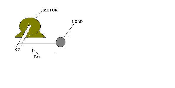

This is one of the first projects I made. I am trying to control a DC servomotor with incremental encoder (FAULHABER 1717V0023 this is the link: http://micromo.com/servlet/com.itmr.waw ... =1596#1596 ). The purpose is place a load on the end of a bar attached to the motor shaft and the motor must keep steadily with no move at all. The motor must stay firm as as shown in the drawing attached. So if I change the mass of the load or if I unload the bar, the motor has to stay immobile. This is the model and the C file I am using in a dsPIC30F4012. It seems to work fine, but sometimes when I am pushing or pulling the bar the motor lose control and start running wildly. Can you please tell me if my design is correct, or if I am not considering something important? Why the motor gets crazy?
Thanks for your help.
Jose Luis
Hello you all.
Jose Luis
