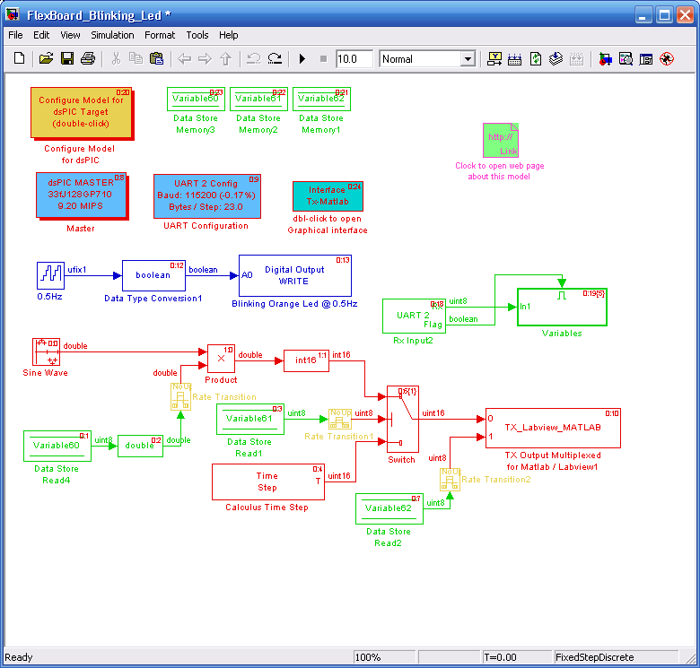

You may have a look on the Flex Board blinking LED example
This example demonstrates how to modify a variable in your model running in real time into your dsPIC, through the UART and using the rs232gui graphical interface available in the blockset.
Please have a look on this one. You may simplify it so as to make testing of your UART interface.
Please let me know if you can use it with theses explanations.
