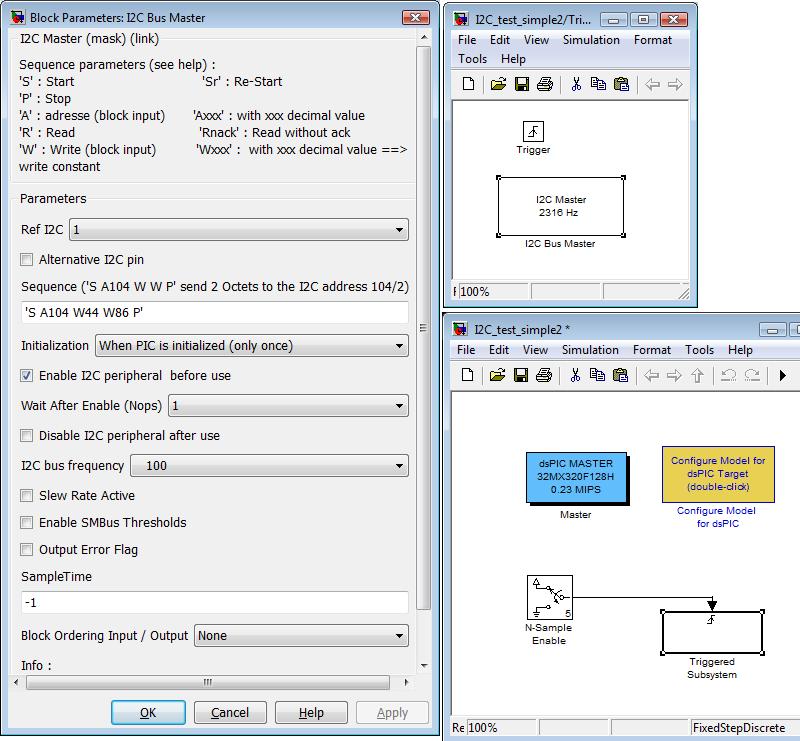

I've got the same problem.
John
I2C_test_simple2.mdl
(29.83 KiB) Downloaded 2607 times
i2cBuildError.txt
matlab output
(4.38 KiB) Downloaded 2598 times
