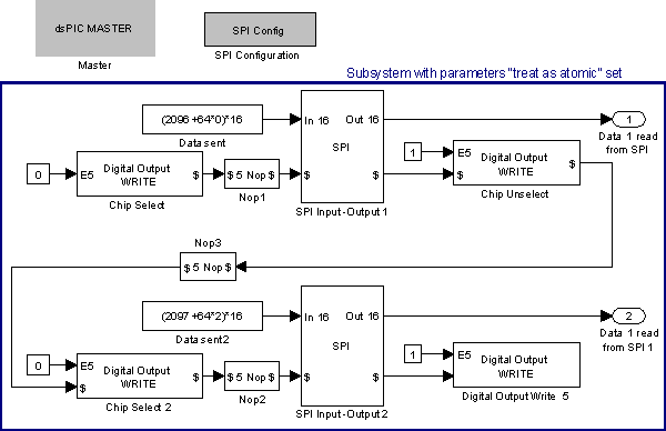

The illustration shows a typical use of the SPI block.
Read 2 SPI data from One Chip
Note the ordering connection between blocks to force the execution order.
Digital Write is used to drive the Chip Select line.
On, this example, we read two different data from the same chip (There is only one Chip Select line: E5)
Also, note the Nop blocks that allow slowing down the start of transmission on the bus after the Chip Select line is enable. This gives time for the Chip Select line to be stable. It is safe to place the SPI logic inside a subsystem with the subsystem parameters "Treat as atomic" checked. This will force all blocks to be executed without being mixed up by execution of others blocks from the model.
