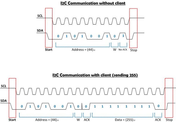

This is how I2C signal should look when everything works fine:
When i look with oscilloscope on the I2C signal of the UDB4, it show non stoping bits in the SDA and SCL without any meaning.

Re: Wrong I2C output on UDB4 board
Post by LubinKerhuel » Mon Mar 26, 2012 11:32 am
Hello Lior,
I just tested and I am getting exactly the same result.
When I2C is beeing used, we should not see so many transition as there is no acknowledge from the other side.
Something's might be wrong with the software.
I did not see errata on this 33Fj256GP710A Chip rgarding I2C.
You might try to check the code generated by the blockset to see if there is anything's wrong.

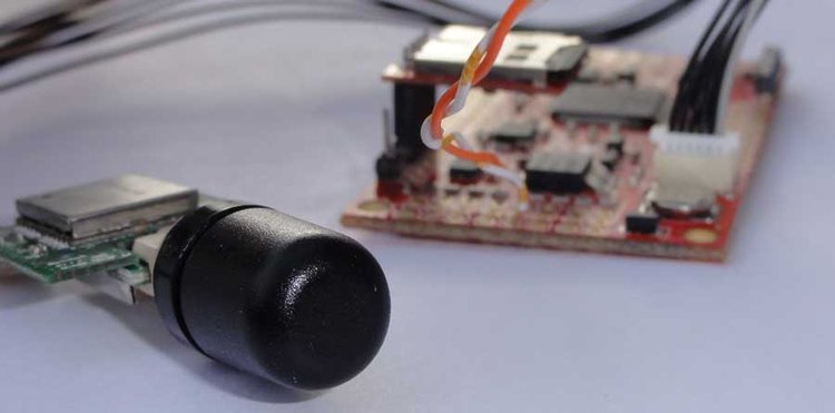

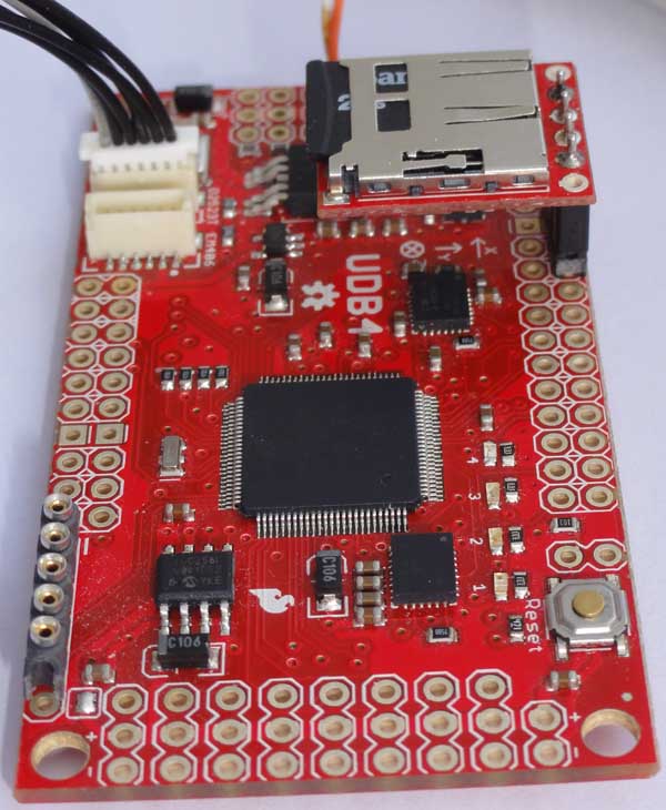

Alternatively, if you are wiling to log data, I tested an interreting solution: openlog which just fit perfectly on the UDB4 board (see pictures).
I was able to set-up long lasting logs (few hours). Only potential problem is the speed of the Flash card (When used with Open Log) which does not allows to log about 2600 bytes/s. Using class 10 flash card does not help. Best result (i.e. log without any data loss) were obtained using an ole transflash 128Mb card (SanDisk). recent Transcend Flash Card Class 10 are just not fast enough.
