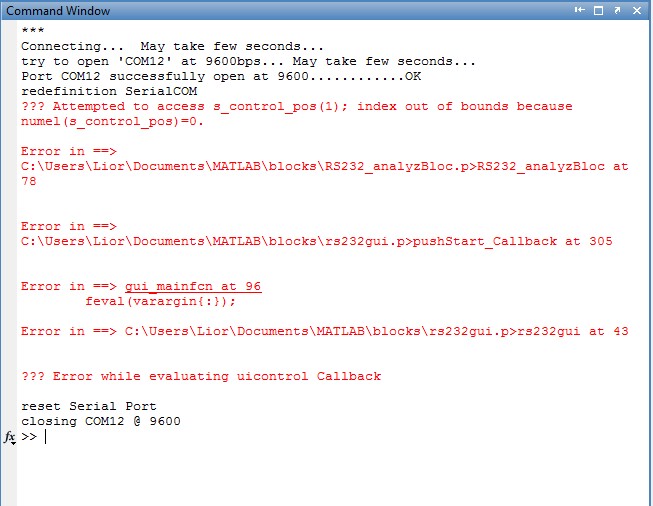

This is the Error that i get:
Error massage
Error massage
I'm using Matlab 2010b and blockset v3.7
What could be the problem?

Alpert, you might try to press the Raw data button in the rs232gui interface.
No decoding will be done, you should get 1 control byte, and 1 value 1 control byte, 1 value etc....
Check that control byte is constant value, and that value is moving correctly (as it is an uint8, it does not need "reconstruction".)
You might check that your quartz is a 2.5MHz precisely.
Try removing I2C preipheral for testing UART only (IC2 will create problems if the I2C composant does not respond as it will freeze the software until timout take over the control)
The, try using a higher bandwidth (here, bandwidth is slow, but the UART is fully load as you try to send 2 char within one time step (1 control byte, 1 uint8 value) ) and the baud rate is too slow to send two byes within 1ms.
Try to get a baud rate for the UART with the lower % error possible (use PLL or change your quartz if necessary).
Note that the protocol used works better when sending several values, and when values are moving (as it makes control byte easier to find out the stream).
