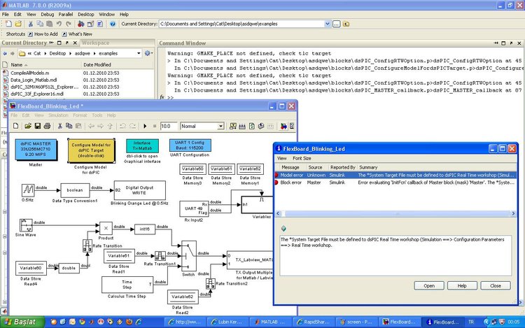

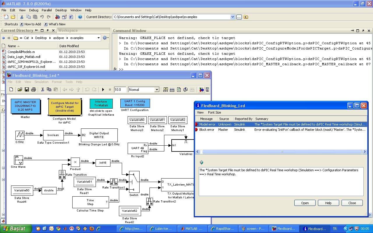

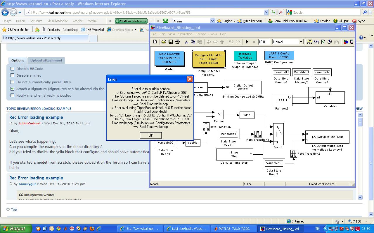

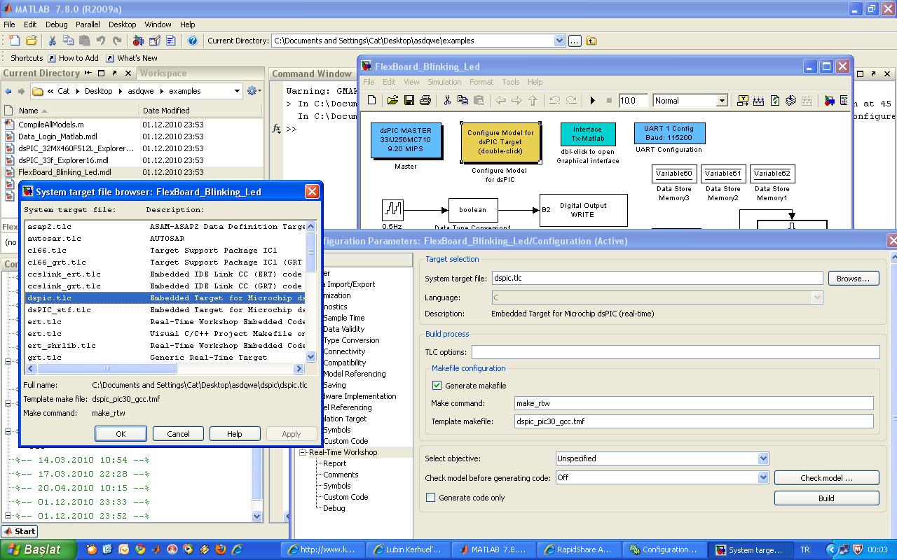

Re: Error loading example
Dear Lubin,
I really appreciate your code but for this version might have a problem. Lets see what we have.
I have R2009a at office and try all the steps again and had the same problem again..
MPLAB C Compiler for dsPIC v3.25 Standard-Eval Version 11/15/2010 3:43:44 PM 47769 KB installed first.
Download dsPIC Toolbox for Matlab R2009a (Matlab 32 and 64 bits) is installed by install_dsPIC_R2009a
Now I can see the toolbox in the list. It is ok!
Let's open the standard Flex example. >> FlexBoard_Blinking_Led.mdl double click >>
dbclick on yellow configure block, we observe the data on command screen... >> screen1 below
target is selected as below on RTW: >> screen2 below
when click to play in diagram: >>screen3 below

Sorry for late response. I ran the testing but a primative error arrises.
Hope that this helps.
After that I have removed the Microchip lib and install your lib again. Still the problem goes on...
thx
onur

Warning: GMAKE_PLACE not defined, check tlc target
> In C:\Documents and Settings\Cat\Desktop\asdqwe\blocks\dsPIC_ConfigRTWOption.p>dsPIC_ConfigRTWOption at 45
In C:\Documents and Settings\Cat\Desktop\asdqwe\blocks\dsPIC_MASTER_callback.p>dsPIC_MASTER_callback at 87
In C:\Documents and Settings\Cat\Desktop\asdqwe\blocks\dsPIC_CalculusTimeStep_initMask.p>dsPIC_CalculusTimeStep_initMask at 6
In C:\Documents and Settings\Cat\Desktop\asdqwe\blocks\dsPIC_UART_Rx_Tx_Matlab_InitMask.p>dsPIC_UART_Rx_Tx_Matlab_InitMask at 9
In general\private\openmdl at 13
In open at 154
In uiopen at 196
Warning: The *System Target File must be defined to dsPIC Real Time workshop (Simulation ==> Configuration
Parameters ==> Real Time workshop.
In open at 154
In uiopen at 196
Warning: Error evaluating 'LoadFcn' callback of Master block (mask) 'Master'. The *System Target File must
be defined to dsPIC Real Time workshop (Simulation ==> Configuration Parameters ==> Real Time workshop.
In open at 154
In uiopen at 196
Warning: In instantiating linked block 'FlexBoard_Blinking_Led/Master' : Invalid setting in Master block
(mask) 'Master' for parameter 'MCLR'.
In open at 154
In uiopen at 196
In open at 154
In uiopen at 196
In open at 154
In uiopen at 196
In open at 154
In uiopen at 196
>> testing.p
> In C:\Documents and Settings\Cat\Desktop\asdqwe\examples\testing.p>testing at 45
??? Error using ==> testing at 81
block_diagram does not have a parameter named 'LDPICTYPE'.
>> testing.p

Warning: Could not find an exact (case-sensitive) match for 'ExecBatch'.
C:\Documents and Settings\Cat\Desktop\asdqwe\dspic\execBatch.p is a case-insensitive match and will be
used instead.
You can improve the performance of your code by using exact
name matches and we therefore recommend that you update your
usage accordingly. Alternatively, you can disable this warning using
warning('off','MATLAB:dispatcher:InexactCaseMatch').
This warning will become an error in future releases.
> In C:\Program Files\MATLAB\R2009a\toolbox\rtw\rtw\private\getSTFInfo.p>getSTFInfo at 73
In rtwprivate at 12
In stf4target at 34
In stf2target at 61
In open at 154
In uiopen at 196
Warning: The following error occurred processing the System Target File '':
Undefined function or method 'exist' for input arguments of type 'cell'.
> In stf2target at 61
In open at 154
In uiopen at 196
Warning: dsPICdrivers.mdl, line 49: block_diagram does not have a parameter named
'CovForceBlockReductionOff'.
In open at 154
In uiopen at 196
In open at 154
In uiopen at 196
In open at 154
In uiopen at 196
In open at 154
In uiopen at 196
Warning: In instantiating linked block 'Servo_ADC/ADC Input' : Invalid setting in dsPIC : ADC10 block
(mask) 'ADC Input' for parameter 'OutFormatBitspopup'.
> In C:\Documents and Settings\Cat\Desktop\asdqwe\blocks\dsPIC_PWM_OC_callback.p>dsPIC_PWM_OC_callback at 94
In open at 154
In uiopen at 196
In C:\Documents and Settings\Cat\Desktop\asdqwe\blocks\dsPIC_ADC_callback_InitMask.p>dsPIC_ADC_callback_InitMask at 9
In open at 154
In uiopen at 196
In open at 154
In uiopen at 196
In open at 154
In uiopen at 196
In C:\Documents and Settings\Cat\Desktop\asdqwe\blocks\dsPIC_ConfigureModelFordsPICTarget.p>dsPIC_ConfigureModelFordsPICTarget at 52

Hi Onur, Hi mickpowell,
Thanks for all your remarks that makes me go forward.
I think I find out the problem. Please give a try to the latest blockset version (3.3b) and let me know if problem is solved.
Thanks
Thanks
Dear Lubin,
I want to congr. you since everything is ok with v3.3b!
See the code below:
Thank you very much!!!
See the code below:
