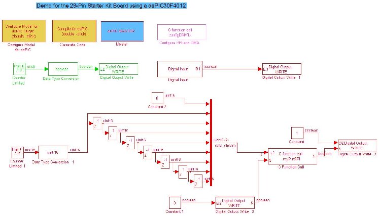

I am trying to pass a vector to the C-Function Call block but apparently it is only getting the first element in that vector: You can see in the image shown below I assemble a vector using a Mux, and then pass it to the C function call, but the call to the function call is this:
Code: Select all
* S-Function "dsPIC_Digital_OutputWrite" Block: <Root>/Digital Output Write3 */
  LATBbits.LATB2 = FALSE;
  /* S-Function "dsPIC_C_function_Call" Block: <Root>/C Function Call */
  myPutSPI(8U);
  /* S-Function "dsPIC_Digital_OutputWrite" Block: <Root>/Digital Output Write2 */
  LATBbits.LATB2 = TRUE;
which is of course wrong since the function myPutSPI is expecting a vector and not a constant. Any ideas what I am doing wrong? Is this a bug? I have attached the code so you can verify it for yourself.

I confirm the bug.
Will fix that shortly !
I propose the following solution (while I am working on that bug !)
- add an output to the C function call block (like char or whatever)
- uncheck the "inline parameters" in Simulation ==> Configuration Parameters ==> Optimization
This solution is working on my blockset version. Note that I already made some change on the C function call block that are not yet published (blockset still in developments).
If you encounter a problem with the "dirty" solution proposed here, let me know.
Anyway, I will correct that bug soon. Thanks for reporting it !

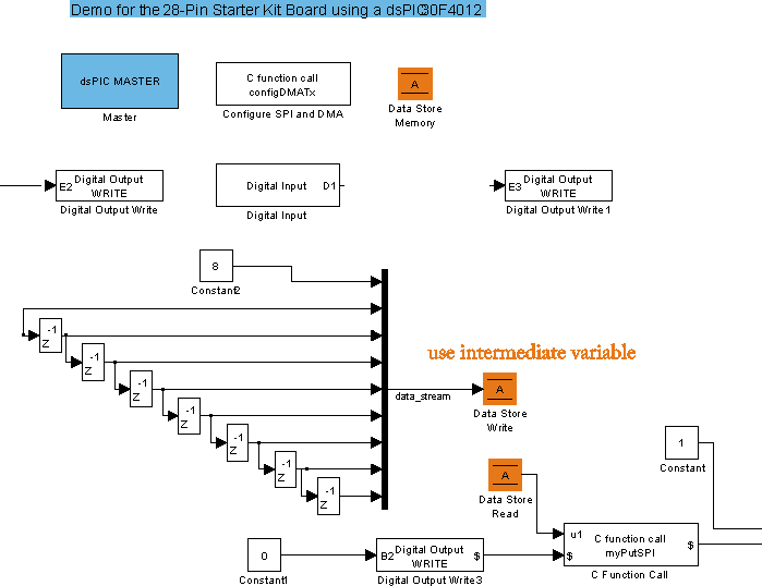

Hi, I corrected the bug : if you have only one input vector, you do not need to add an (unused) output to the function.
This will be available in the next version (i.e. 0.97b)
Remark about the inline parameters :
When the C call function use input vectors with more than 2 elements (an array in C language), the adress of the first element (pointer) is passed to the C function .
In your exemple, when inline parameters is checked in simulink options, the first element of the array is a constant. This constant may not be stored next to the remaining vector variables values.
When inline parameters, the vectors intern variable usually follows each other in memory. (from experiment, I did not read anything about it)
Thus, I suggest to use an intermediate variable :
C function Call with vector input and intermediate variable (Simulink &quot;inline parameters&quot; option checked)
C function Call with vector input and intermediate variable (Simulink "inline parameters" option checked)
I wish you good luck with SPI using DMA !
