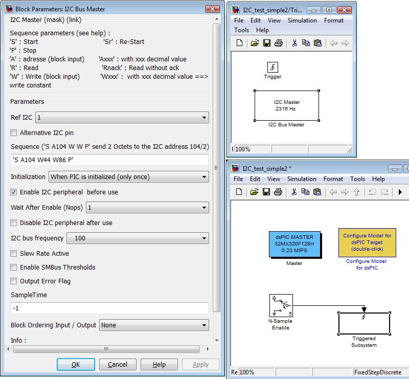

Please look into this. I believe it is a bug.

I2C does not build on PIC32
- i2cBuildError.txt
- build output with error
- (4.38 KiB) Downloaded 1159 times
- I2C_test_simple2.mdl
- (29.81 KiB) Downloaded 1165 times

However, if the problem is just one bit MI2C1IF whose name changed, I might solve it pretty easily.
Do you think the problem is limited to this ?

My C expert, Konstantin, says:
"Probably not, although it most likely will not be too much work to fix.
In the I2CCON register in particular, going from the dsPIC family of microcontrollers to the PIC32, the I2CCON register gets renamed I2CxCON where x is the I2C module number. Also within the I2CCON register itself the I2CEN and I2CSIDL bits get renamed ON and SIDL in the PIC32 hardware."
