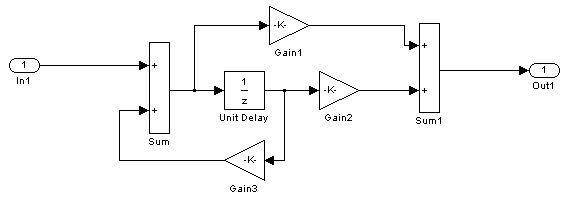

Re: Did anyone implement a controller in dsPIC by this toolbox?
The controller model presented has problem with the Gain 3; It must be negative...
Gain 3 and Gain 2 MUST be negative...
...and do not try any positive feedback design in your systems unlesss you are designing Variable Structure System Design...
This Gain -koefficient in the first intrgrator feed back must be negative.
...in both the Plant and the controller.
The controller presented is not performing PI.
If the Gain is negative then we have a first order filter responce added to Proportional K...
Ones you have negative gain ofcourse.
Then you will have an "I" component to "P", which will be working for 0.63 of the Time Cte for this First order structure. And no MORE...
After that - in study State...this 1 Order will add extra proportional actuating...
You will miss the "I" Integral component in PI...therefore, a big Static Error (studyState...Tracking...error.) will never be compensated to be ZERO.
Back to Simulink...
Lubin is right about using Integrators...always limit them...and be ready to reset the Initial Conditions !!!!!
Happy Simulating,
Todor
Thanks for your continuing attention.
And Todor,
Your explanation is right. But I don't think it will cause the problem, feedback loop of 'direct form' still can be negative. As 'sign' can be changed straight in 'gain' block. Actually, I put the negative cofficients in 'gain' blocks directly. The problem for the model first uploaded is not the compensator. The reason is my hardware is not supported by Lubin's blockset initially, when Lubin upgrade the blockset for me, the problem was solved. The controller with dsPIC woked fine in real machine testing.
Cheers
