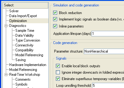

First of all, checking the "inline parameters" greatly reduce RAM usage. (It means that all constant variables are stored inside the ROM memory rather than inside the RAM)
Menu : Simulink \ Simulaiton ==> Configuration parameters ==> Optimization ==> inline parameters checkbox

As for the first one (checking inline parameters), it increased the memory usage performance by 50%.
In other words, I can take 450 history length compared to 300 before.

So your general advise is to use inline parameters always? or just for this application?
This is Masaki.
My way of understanding is this:
- When you have a plenty of ROM area, chech inline parameters.
- When you don't have enough ROM area, don't check inline parameters.
In my application, the program is fairly simple but requires a large amout of RAM to keep data history.
So I used inline parameters.
