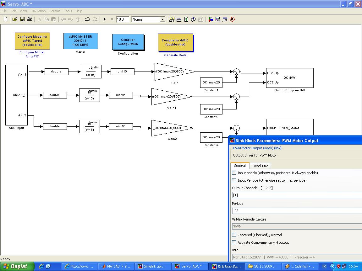

1. You said I could use PWM motor block for servo outputs, I still can not have any outputs from servo outputs. On the model which I attached, I have moving servos from the OC channels and they look fine but I still can not have any outputs from servo output ports.
As you said I get O1 (PWMH1, RE1), O2 (PWMH2, RE3) and O3 (PWMH3, RE5) pins. For example in Digital output write, we assign the output port like RE1 or RE3. Do i forget to assign my PWM ports like that or something else? I am confused.
2. In the picture I uploaded, you can see that there is nothing above input enable selection, I mean I can not select PWM 1 or PWM 2.
Thank you very much again, I am looking forward to have your answer.

Hello, I noticed few things.
Please try the following modification :
First of all, change OC1max variable (used for normalizing signals) :
For OC (HW) block, you must use OCmax variable (is set to 9999 in matlab workspace)
For PWM motor block, you must use PWM (is set to 40000 in matlab workspace)
If you have a scope, do you have a signal on the PWM motor output block?
If you have a servo, does the servo try to get on the extreme position (because of the normalization error here)
If so, it should works now with the correction above.

Post by zafer » Tue Apr 27, 2010 8:18 am
You are great !!! I tried the modifications you said and now servos are dancing :D
