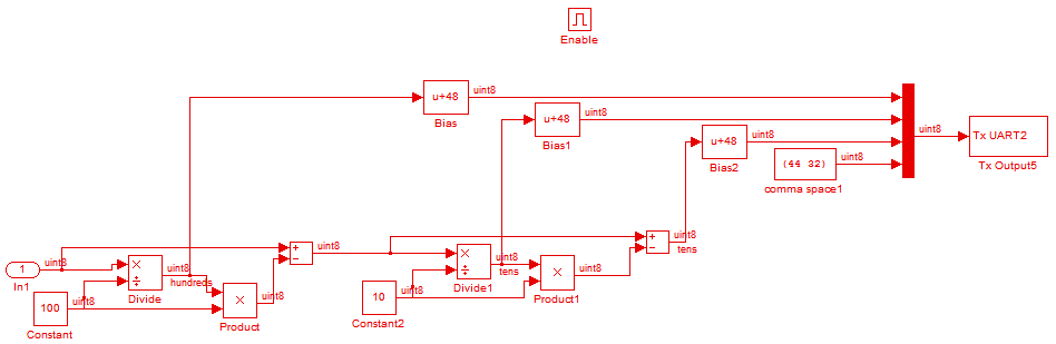

Re: Rx Interrupt buffer size
I posted an image of your model that run on Evidence Flex Board (They gracefully provide one for me, so many thanks)
Model run here at 2Khz that is a time step of 0.5ms.
@ 115200, you can send or receive 5.68 bytes within one time step.
The model is here awaiting for only one data (uint8) that will produce its decimal representation with added a coma and a space: thus, it produce within each time step 5 data
2 potential problems :
1) What if no data are received on the UART1 within one time step?
==> The model will generate the five data that will be 0 as the output Default parameters of the Rx block is set to 0. It may be the last received value if the output default parameter of the Rx block is set to -1.
You probably want no output data when there is no input data. Thus, use the flag of the UART block to enable a subsystem where you place this part of the model.
2) What if 5 data [1 2 3 4 5 ] are received on the physical Rx line (UART 1) within one time step?
The Rx block will only output the first data [1]. This is quite good as you could not generate more than 5 data on the output within one time step.
Data [2 3 4 5} are not lost and the second one is on the Rx block output on the next time step. Use interrupt with a large buffer is you are to receive lots of data at once (like 20 data at full 115200 speed).
Anyway, I post a proposition of model. I did not test it, but give it a try.
Other solutions exist, for example just checking the Blocking Function of the Rx block to avoid the enabled subsystem. However, nothing could run in parallel with this last solution!
From UART config blocks, you can get how many data can be read at each time step.Model run here at 2Khz that is a time step of 0.5ms.

Thanks. The use of enabled subsystems might work, but I think my problem with my own models and with the one you just posted is this:
I can not control the sequence of the data going out UART2. Muxed signals to UART Tx seem to mix up bits producing bad output. Ordered Tx blocks are not working--it appears that the earlier ones are transmitting and the program never gets to the later ones even if I use a large step time. I tried many variations including a series of enabled subsystems controlled by out-of-phase square wave triggers.
I don't see why the ordering ot Tx blocks is not working; maybe I don't understand the intent.
My colleague is suggesting a "For Iterator" to contol processing byte-by-byte. I have not tried it yet. I would like to hear your ideas. His proposal is this:
set a for loop with N=11 for 11-byte Rx messages, and nest another for loop within to separate digits and insert commas and spaces, and Tx.

It may works, however three remarks:resodad wrote:set a for loop with N=11 for 11-byte Rx messages, and nest another for loop within to separate digits and insert commas and spaces, and Tx
1) Theses nested for-loop are going to take more time than one time step. Thus, you will not respect real-time constraints. Are you planning to run some signal processing at the same time?
2) How do you know that there is a data at the Rx ? you will need an enable subsystem !
3) finally, it's quite complicated and you should avoid that
Weird. When I am looking at the generated code, all seems Ok.resodad wrote:Muxed signals to UART Tx seem to mix up bits producing bad output
Also weird:resodad wrote:Ordered Tx blocks are not working
check order in simulink : Format ==> Block displays ==> Sorted Order it is Ok
Check generated code report: it seems also Ok.
Anyway, the problem may come from the UART speed which is not 100% compatible with the quartz used:
The closest UART speed to 115200 achieved by the dsPIC is 113636. That is an error of 1.36% of relative speed error. It is not a lot, but depending on peripheral connected to the dsPIC, it may cause problems.
Or,
There may be a bug in the interrupt of the UART software, but that would be quite a surprise as this part of code has been used for a very long time now and seems to be 100% ok.
Thus, I would suggest making some test by sending constant value through the UART to make sure the problems do not come from the UART error speed.
If you connect constant to an UART Tx block, make sure that you set a sampling rate of the constant block to something like .001. It must be different from -1 or 0 otherwise the model is likely to send only one data at startup! (This is a comon error)
Another simple test is to connect the Rx block to the Tx block and check it’s working (just add 1 to the receive value before to send it to make sure that you are reading the correct value)

Thanks.
I don't know what those "Errors" came from, maybe I was not viewing output data corretly.
Here is a file that appears to be working now. Sorry, but I dont know how to insert images directly in the forum here. See the attached files.
John
John
- UART_2D_table V3.zip
- Simulink model, matlab m file, and source code
- (110.32 KiB) Downloaded 1652 times
- Convert UART1 in to ASCII UART2 out Using 2D Look-Up Table.docx
- description of the project
- (172.26 KiB) Downloaded 1612 times

Thanks for your detailed explanation.
This is a quite original solution that will be very fast. As this dsPIC has a lot of memory, it's just fine like this. You may optimize a bit by storing data of the lookuptable in the uint8 format (enter uint8(T) ).
