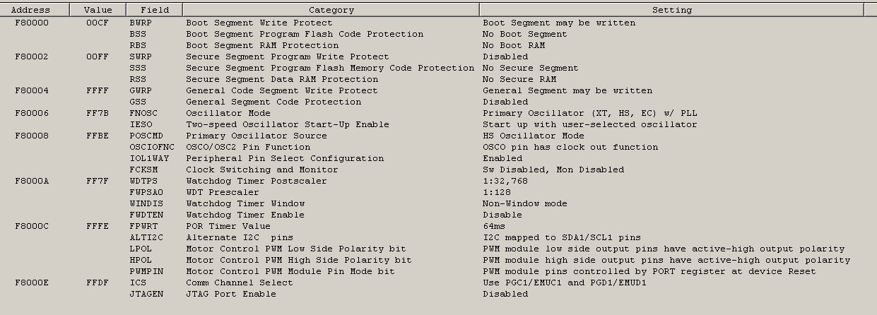

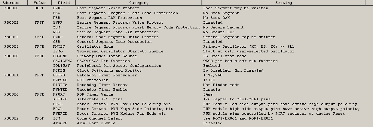

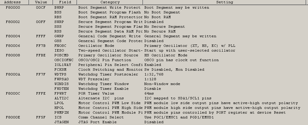

Re: Support for CAN Module?
When I use MPLAB, it works both ways (debug, release)...
Config Bits:
There are differences on F80002 and F8000E... not that I do know why, but somehow It does not seem unexpected
I guess that the problem can be in F80002, as that is the difference between working and not working...
update: I am looking at note 25 - device config:
F80002 is FSS - Secure Code Segment Configuration Register
00FF
FFFF
If I read interpret those values correctly: according to section 25: bit 23-8 are Unimplemented, therefore there should be no difference between 00FF and FFFF hmm.. that is just 16 bits?
as for F8000R - FICD
FFDF 1111 1111 1101 1111
FF5F 1111 1111 0101 1111
5 bit: Jtag off when 0
7 bit: Reserved, do not use. ?!
I am confused :/
Let me know how to force first 8 bits of FSS to 0.
I can't force them adding & 255 into :
Code: Select all
_FSS( RSS_NO_RAM & SSS_NO_FLASH & SWRP_WRPROTECT_OFF & 255)
