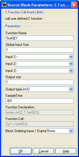

Re: Implementing the C Function Call
Hello All,
It is with great pleasure that I give you an example Simulink Model of how to use the C function call to implement the QEI in a dsPIC30F4011. This is proven to work and if anybody has a question feel free to post it. Attached to this are two files: the Simulink model and the C file. Note that if you roll your own you need to add the C file to the Simulink options. The example is fully interrupt driven and supports more than one turns (in any direction of course
I guess using the C function call is a great reason to buy any of the registered versions
Hope this is helpful to anyone looking to use the QEI.

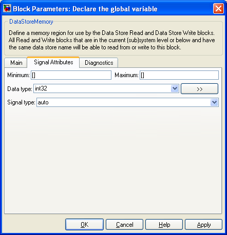

I declared the global variable using a different way. (yours may be better for this example).
I do not like the way you initialize the QEI peripheral. It would make better C code to set its sampling time to inf !
It was quite long to make the example; I respond quickly, refer to the example for further details.
You must declare (in the Data Store Memory) the variable as global, assign its name in order to be able to use this variable in your C function written. In your C file, the variable will be declared as external. You must declare the variable with the same datatype.
The following example compile but has not been tested. I don't know if this implementation of QEI function is working. I guess modifications will be required. I hope that the example is not too hard to read.
The model and C file can be download at the end of the post.

To implement a function that has no "interface" with the model (kind of internal function, like interrupt) . You do not need to use the C function call block. Just add the function in the C file that you declared in the Configuration Parameters dialog box.malife wrote:1.- A way to override your default function prototype
You already have the solution! I think it is better to enter into the simulink logic rather than adding a option for initialization.malife wrote:2.- A way to decide whether it should be called once at the beginning
(which I think you can by setting the sample time to inf), every cycle
(by setting the sample time) or never (like an interrupt which is
called by the microcontroller interrupt engine).
- initialization (call only once at startup) ==> sample time = inf
call ==> sample time = sampling time desired
Interrupt ==> do not need using a C function call block.
It is possible to use block 'Data Store Memory', 'Data Read Memory' and 'Data Write Memory' which are block of the standard simulink library.malife wrote:And then provide a small block that declares a global variable (with a
given name) and initializes it a to given value and returns the
current value each sample time.
I also attached a basic example (the one I sent to you Mariano) that shows how to use different calling method to transfer data between simulink and C functions (using pointer or direct value...this example is not described on this post).
I noticed that some images do not load correctly. It is a strange behaviour of the forum ; I guess there is too many image in this post. Reloading the page seems to gives results... (Press F5)
C file content (Modified versioin of Mariano's proposition):
