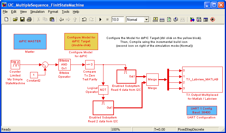

On the example I have build, I read only
- 4 data for states 1 ; 3 and 5
- 2 data for states 2 ; 3 and 6
But you can easily adapt it to read 18 and 12 data.
I use an Enabled Subsystem to choose wether I am reading 4 or 2 data.
The model :
I use a bus to gather the data. When reading only 2 data, I place 0 into into the unfilled data.
Using a bus with a constant width of 4 is up to you. You could use the I2C data in a different way.
The merge block output the most recent data (refere to simulink help)
I2C_MultipleSequence_FinitStateMachine.mdl
