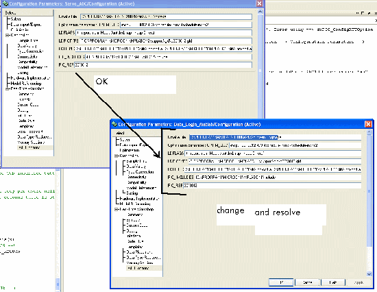

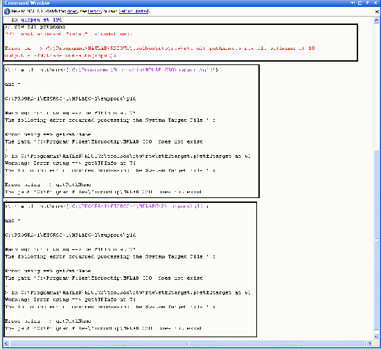

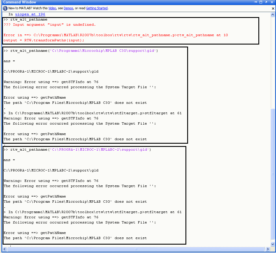

Re: How to change directory?

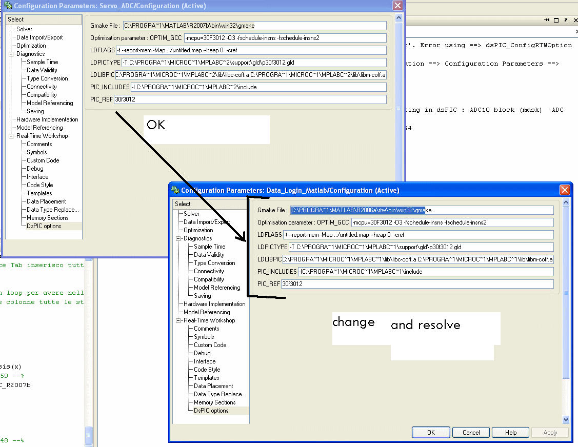

from viewtopic.php?f=5&t=73#p152 :
Simulation ==> Configuration Parameters ==> Real-Time Workshop ==> DsPIC options
(part 2 of the solution)
did you correct the parameters in the simulink model :LubinKerhuel wrote:You can check by typing at the matlab prompt the command:
rtw_alt_pathname('C:\Program Files\Microchip\MPLAB C30')
If you do not get C:\PROGRA~1\MICROC~1\MPLABC~1, you will have to change the short path in Simulink :

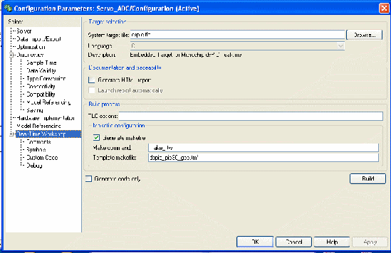

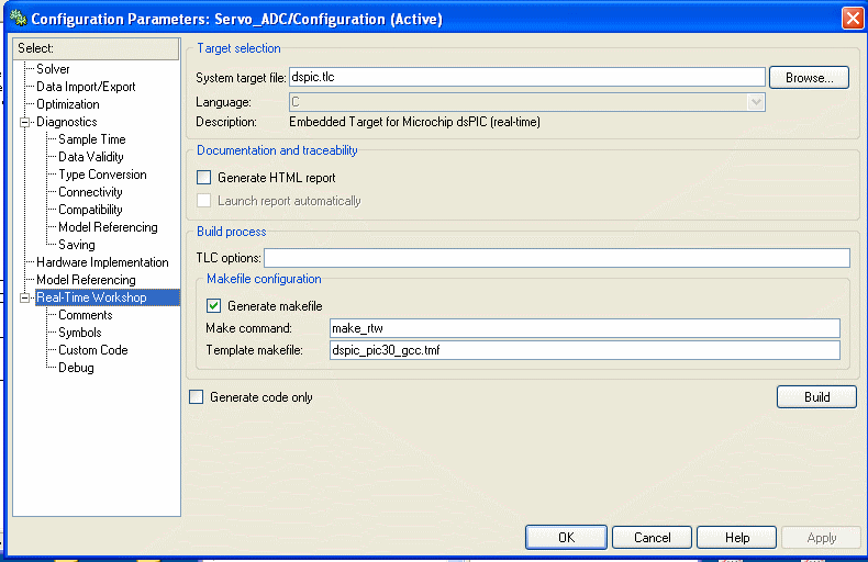

Something is wrong.
In the Real Time Workshop , you have
- Comment
- Symbols
- Custom Code
- Debug
You should have
- Comment
- Symbols
- Custom Code
- Debug
- DsPIC options
Could you try to select another target than dsPIC.tlc (ert.tlc or any other), click apply, then, choose again dsPIC.tlc, click apply and look at the command windows for any error? Could you report the error you get here?

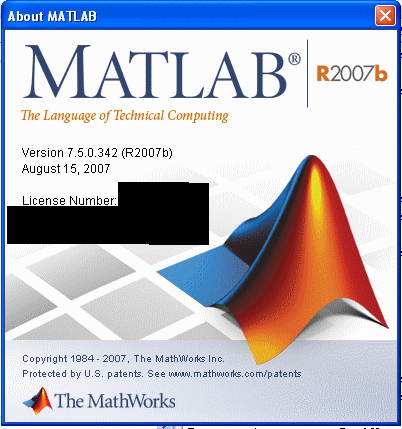

Which matlab version are you using?
I will try to find out what's happening as soon as I can...

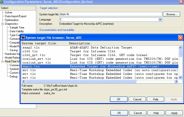

Hi,
The file dspic.tlc is correct but when load there isn't "DsPIC options"

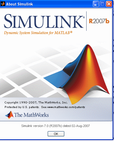

and I've simulink version :
- MWSnap.gif (46.79 KiB) Viewed 75705 times

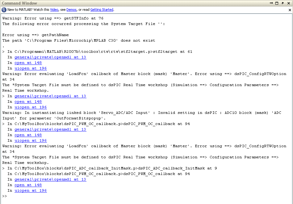

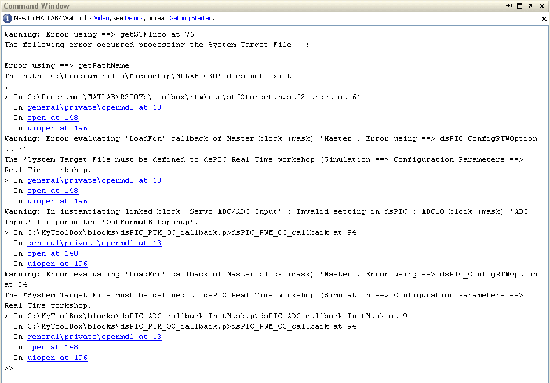

Error:
Warning: Error using ==> getSTFInfo at 76
The following error occurred processing the System Target File '':
Error using ==> getPathName
The path 'C:\Program Files\Microchip\MPLAB C30' does not exist
> In C:\Programmi\MATLAB\R2007b\toolbox\rtw\rtw\stf2target.p>stf2target at 61
In general\private\openmdl at 13
In open at 148
In uiopen at 196
Warning: Error evaluating 'LoadFcn' callback of Master block (mask) 'Master'. Error using ==> dsPIC_ConfigRTWOption
at 34
The *System Target File must be defined to dsPIC Real Time workshop (Simulation ==> Configuration Parameters ==>
Real Time workshop.
In open at 148
In uiopen at 196
Warning: In instantiating linked block 'Servo_ADC/ADC Input' : Invalid setting in dsPIC : ADC10 block (mask) 'ADC
Input' for parameter 'OutFormatBitspopup'.
> In C:\MyToolBox\blocks\dsPIC_PWM_OC_callback.p>dsPIC_PWM_OC_callback at 94
In open at 148
In uiopen at 196
at 34
Real Time workshop.
> In C:\MyToolBox\blocks\dsPIC_ADC_callback_InitMask.p>dsPIC_ADC_callback_InitMask at 9
In open at 148
In uiopen at 196
In C:\Programmi\MATLAB\R2007b\toolbox\rtw\rtw\@RTW\@TargetBrowser\uploadTarget.p>uploadTarget at 20
In C:\Programmi\MATLAB\R2007b\toolbox\rtw\rtw\private\targetBrowserCloseCB.p>targetBrowserCloseCB at 9
In C:\Programmi\MATLAB\R2007b\toolbox\rtw\rtw\rtwprivate.p>rtwprivate at 12
In simulink\private\configDlgAction at 93
In slprivate at 12
In slprivate at 12
In open at 148
In uiopen at 196
at 34
Real Time workshop.
In open at 148
In uiopen at 196
In open at 148
In uiopen at 196
at 34
Real Time workshop.
In open at 148
In uiopen at 196
In slprivate at 12
In slprivate at 12

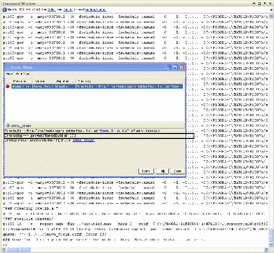

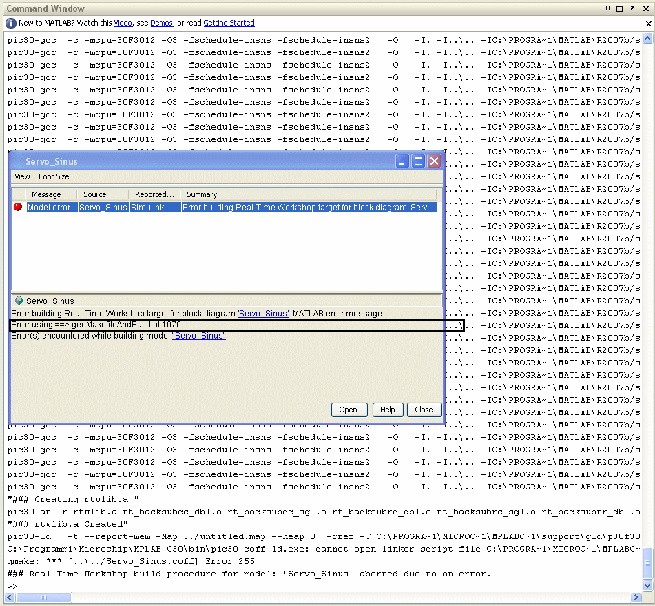

There is a problem, when compiling example "Servo_ADC.mdl" work very well , but when compiling another example give me error:
I can't see the error on the image (it is cut) however, I guess that it says that the linker script ***.gld is missing.
This script is provided with the C30 compiler. Could you check that you installed it and that it is present in the correct directory?

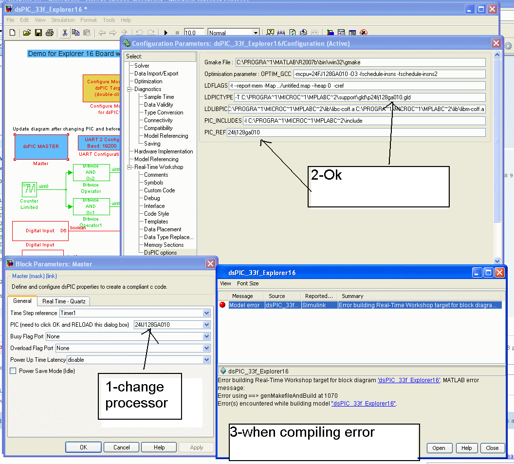

Ok resolve it , the problem is :
Now all the examples are compiled perfectly.
But I did a test in dsPIC33_f_Explorer16 I changed into "dspic master processor in the box PIC24fj128GA10, make an error "Error ==> genMakefileAndBuild at 1070"
change processor and the error is:
Code: Select all
Embedded Coder for dsPIC V0.96b(13-Feb-2008) for Matlab R2007b.
Licence Accorded to Demonstration Version -
informations available at www.kerhuel.eu
### Processing Template Makefile: C:\MyToolBox\dspic\dspic_pic30_gcc.tmf
### Wrapping unrecognized make command (angle brackets added)
### <C:\PROGRA~1\MATLAB\R2007b\bin\win32\gmake>
### in default batch file
### Creating dsPIC_33f_Explorer16.mk from C:\MyToolBox\dspic\dspic_pic30_gcc.tmf
### Building dsPIC_33f_Explorer16: .\dsPIC_33f_Explorer16.bat
C:\MyToolBox\examples\dsPIC_33f_Explorer16_dspic\sources>set MATLAB=C:\Programmi\MATLAB\R2007b
C:\MyToolBox\examples\dsPIC_33f_Explorer16_dspic\sources>C:\PROGRA~1\MATLAB\R2007b\bin\win32\gmake -f dsPIC_33f_Explorer16.mk GENERATE_REPORT=1 MULTI_INSTANCE_CODE=0 PORTABLE_WORDSIZES=0 GENERATE_ASAP2=0 TMW_EXTMODE_TESTING=0
pic30-gcc -c -mcpu=p24FJ128GA010 -O3 -fschedule-insns -fschedule-insns2 -O -I. -I..\.. -IC:\PROGRA~1\MATLAB\R2007b/simulink/include -IC:\PROGRA~1\MATLAB\R2007b/extern/include -IC:\PROGRA~1\MATLAB\R2007b/rtw/c/src -IC:\PROGRA~1\MATLAB\R2007b/rtw/c/ert -IC:\PROGRA~1\MATLAB\R2007b/rtw/c/src/ext_mode/common -IC:\MyToolBox\examples\dsPIC_33f_Explorer16_dspic\sources -IC:\MyToolBox\examples -IC:\PROGRA~1\MATLAB\R2007b\rtw\c\libsrc -I C:\PROGRA~1\MICROC~1\MPLABC~2\include dsPIC_33f_Explorer16_main.c
pic30-coff-cc1.exe: error: Invalid -mcpu option. CPU p24FJ128GA010 not recognized.
gmake: *** [dsPIC_33f_Explorer16_main.o] Error 255
### Real-Time Workshop build procedure for model: 'dsPIC_33f_Explorer16' aborted due to an error.
Warning: In instantiating linked block 'dsPIC_33f_Explorer16/Master' : Invalid setting in Master block (mask)
'Master' for parameter 'MCLR'.
In open at 148
In uiopen at 196
Number of I/O PINs used : 6
### Starting Real-Time Workshop build procedure for model: dsPIC_33f_Explorer16
### Generating code into build directory: C:\MyToolBox\examples\dsPIC_33f_Explorer16_dspic\sources
Warning: Source 'dsPIC_33f_Explorer16/Digital Input' specifies that its sample time (-1) is back-inherited. You
should explicitly specify the sample time of sources. You can disable this diagnostic by setting the 'Source block
specifies -1 sample time' diagnostic to 'none' in the Sample Time group on the Diagnostics pane of the
Configuration Parameters dialog box.
### Invoking Target Language Compiler on dsPIC_33f_Explorer16.rtw
tlc
-r
C:\MyToolBox\examples\dsPIC_33f_Explorer16_dspic\sources\dsPIC_33f_Explorer16.rtw
C:\MyToolBox\dspic\dspic.tlc
-OC:\MyToolBox\examples\dsPIC_33f_Explorer16_dspic\sources
-IC:\MyToolBox\dspic
-IC:\MyToolBox\blocks
-IC:\MyToolBox\examples\dsPIC_33f_Explorer16_dspic\sources\tlc
-IC:\Programmi\MATLAB\R2007b\rtw\c\tlc\mw
-IC:\Programmi\MATLAB\R2007b\rtw\c\tlc\lib
-IC:\Programmi\MATLAB\R2007b\rtw\c\tlc\blocks
-IC:\Programmi\MATLAB\R2007b\rtw\c\tlc\fixpt
-IC:\Programmi\MATLAB\R2007b\stateflow\c\tlc
-aEnforceIntegerDowncast=0
-aFoldNonRolledExpr=1
-aInlineInvariantSignals=1
-aInlineParameters=1
-aLocalBlockOutputs=1
-aRollThreshold=5
-aZeroInternalMemoryAtStartup=0
-aZeroExternalMemoryAtStartup=0
-aInitFltsAndDblsToZero=0
-aGenerateReport=1
-aGenCodeOnly=0
-aRTWVerbose=1
-aIncludeHyperlinkInReport=1
-aLaunchReport=1
-aGenerateTraceInfo=0
-aForceParamTrailComments=0
-aGenerateComments=1
-aIgnoreCustomStorageClasses=0
-aIncHierarchyInIds=0
-aMaxRTWIdLen=31
-aShowEliminatedStatements=0
-aIncDataTypeInIds=0
-aInsertBlockDesc=0
-aSimulinkBlockComments=1
-aInlinedPrmAccess="Literals"
-aTargetFcnLib="ansi_tfl_table_tmw.mat"
-aGenFloatMathFcnCalls="ANSI_C"
-aIsPILTarget=0
-aIncludeMdlTerminateFcn=0
-aCombineOutputUpdateFcns=1
-aSuppressErrorStatus=1
-aERTCustomFileBanners=1
-aLogVarNameModifier="rt_"
-aGenerateFullHeader=1
-aGenerateSampleERTMain=0
-aMatFileLogging=0
-aMultiInstanceERTCode=0
-aPurelyIntegerCode=0
-aPortableWordSizes=0
-aGenerateErtSFunction=0
-aGenerateASAP2=0
-aExtMode=0
-aExtModeStaticAlloc=0
-aExtModeStaticAllocSize=1000000
-aExtModeTransport=0
-aExtModeTesting=0
-aInlinedParameterPlacement="NonHierarchical"
-aTargetOS="BareBoardExample"
-aMultiInstanceErrorCode="Error"
-aRateGroupingCode=1
-aRTWCAPISignals=0
-aRTWCAPIParams=0
-aRootIOStructures=0
-aERTCustomFileTemplate="dsPIC_main.tlc"
-aGMAKE_PLACE="C:\PROGRA~1\MATLAB\R2007b\bin\win32\gmake"
-aOPTIM_GCC="-mcpu=24FJ128GA010 -O3 -fschedule-insns -fschedule-insns2"
-aLDFLAGS="-t --report-mem -Map ../untitled.map --heap 0 -cref"
-aLDPICTYPE="-T C:\PROGRA~1\MICROC~1\MPLABC~2\support\gld\p24fj128ga010.gld"
-aLDLIBPIC="C:\PROGRA~1\MICROC~1\MPLABC~2\lib\libpic30-coff.a C:\PROGRA~1\MICROC~1\MPLABC~2\lib\libpPIC24Fxxx-coff.a C:\PROGRA~1\MICROC~1\MPLABC~2\lib\libc-coff.a C:\PROGRA~1\MICROC~1\MPLABC~2\lib\libm-coff.a"
-aPIC_INCLUDES="-I C:\PROGRA~1\MICROC~1\MPLABC~2\include"
-aPIC_REF="24fj128ga010"
-p10000
### Loading TLC function libraries
### Initial pass through model to cache user defined code
### Caching model source code
### Writing main
### Writing header file dsPIC_33f_Explorer16_types.h
### Writing header file dsPIC_33f_Explorer16.h
### Writing source file dsPIC_33f_Explorer16.c
### Writing header file dsPIC_33f_Explorer16_private.h
### Writing header file autobuild.h
### Writing source file dsPIC_33f_Explorer16_main.c
### TLC code generation complete.
### Creating HTML report file dsPIC_33f_Explorer16_codegen_rpt.html
### Evaluating PostCodeGenCommand specified in the model
Companie =
pic30-gcc -c -mcpu=24FJ128GA010 -O3 -fschedule-insns -fschedule-insns2 -O -I. -I..\.. -IC:\PROGRA~1\MATLAB\R2007b/simulink/include -IC:\PROGRA~1\MATLAB\R2007b/extern/include -IC:\PROGRA~1\MATLAB\R2007b/rtw/c/src -IC:\PROGRA~1\MATLAB\R2007b/rtw/c/ert -IC:\PROGRA~1\MATLAB\R2007b/rtw/c/src/ext_mode/common -IC:\MyToolBox\examples\dsPIC_33f_Explorer16_dspic\sources -IC:\MyToolBox\examples -IC:\PROGRA~1\MATLAB\R2007b\rtw\c\libsrc -I C:\PROGRA~1\MICROC~1\MPLABC~2\include dsPIC_33f_Explorer16_main.c
In file included from c:/programmi/microchip/mplab c30/bin/../support/h/peripheral_24F/timer.h:34,
from dsPIC_33f_Explorer16_private.h:33,
from dsPIC_33f_Explorer16_main.c:28:
c:/programmi/microchip/mplab c30/bin/../support/h/peripheral_24F/Generic.h:56: error: syntax error before '(' token
PS: excuse me for my screenshoot and my english
And thank you for your disponibility

There is a know bug for 24fj PIC.
I do not know why, if anybody has a suggestion.
The solution is described on the release page: http://www.kerhuel.eu/RTWdsPIC/ReleaseNotes.html
Know bug : before compiling schematic for dsPIC 24f, you must remove the line 56 of Generic.h file which is in
"C:\Program Files\Microchip\MPLAB C30\support\h\peripheral_24F"
The line :
"typedef enum _BOOL { FALSE = 0, TRUE } BOOL;" does not compile !
Sorry I had not seen, now everything works perfectly thanks
