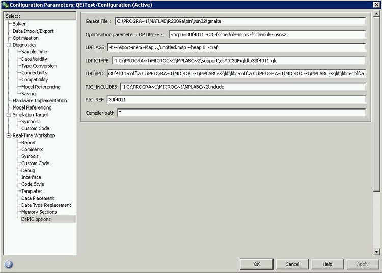

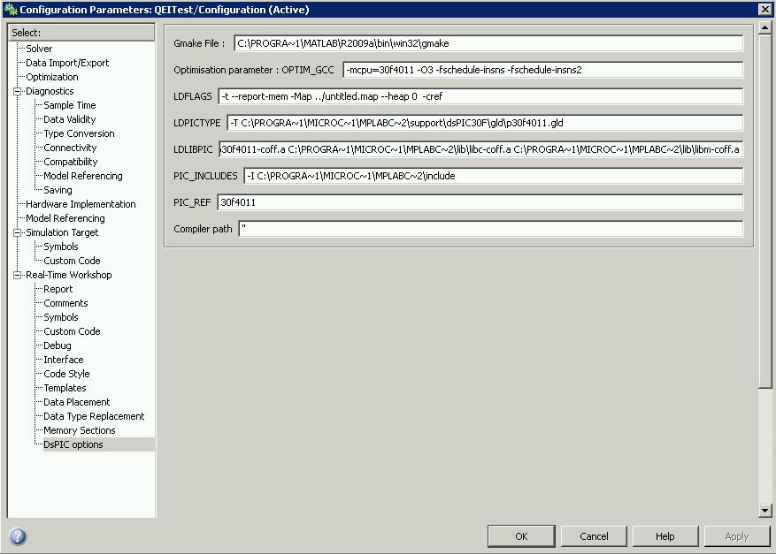

Bobes
Posts: 36
Joined: Wed Nov 25, 2009 11:27 am
Location: Brno, CZE
Re: Build error in function rt_MatMultAndIncCC_Dbl
Post by Bobes » Sat Jan 23, 2010 10:59 am
Hello John, may be I can help... I belive I hade same problem:
Try clicking on the block "Configure Simulink for dsPIC Target", I belive you have somewhere the path in form "C:\Program Files\..." and it should be in the "DOS" format.. like this: "C:\PROGRA~1\..."
That is I think why is there this message:
Code: Select all
gmake: command not found: C:\Program
go to Simulation/Configuration parameters ... should look similar like on the attachment, just configured bit differently for your target..
Post by LubinKerhuel » Sun Jan 24, 2010 12:29 am
Hi John,
Bobes provided a good advice.
You may also try to click on the yellow block titled something like "configure simulink for dsPIC target". This block automatically check all path and should solve problems. If it did not do the job, I would be interrested to get the parameters of your computer to make this block algorithm even more robust.

Thus, installed examples do not compile when you install it newly, but the models you created, that are thus not replaced compile ?
This is due to path. The examples path are set for my computer. However, theses path error should be corrected with the yellow block "configure simulink for dsPIC"
