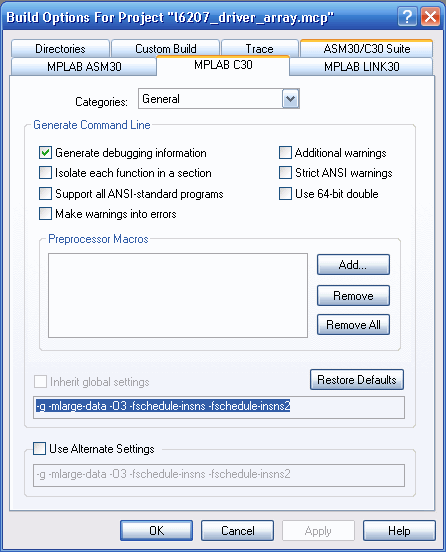

In order to debug code generated by RTW and Lubin's blockset in MPLAB v8.60 (where you can follow the execution of a program, set breakpoints, etc), I have found you need to do one of the following:
1) Manually create your own project, and manually add the .c and .h files to your project; compile and debug in MPLAB.
--or--
2) If double clicking on the project file (.mcp) created by Lubin's blockset, and you want to see program execution / set breakpoints, you need to turn on "Generate debugging information" in MPLAB under Build Options -> Project -> MPLAB C30. Otherwise, even if you compile a debug build, it will not show program execution or allow breakpoints.
Hope that saves someone some time!
