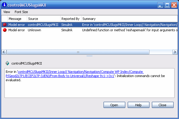

TPTWarning: Input port 1 of 'controlMCUSlugsMKII/Trim Vals/Log  Trims
Using PWM High [groundStationDriver.c]/Report Airspeed' is not
connected.
Warning: Output port 1 of 'controlMCUSlugsMKII/Update PWM Commands
and Send Telemetry/[dR dE dA dT]2' is not connected.
and Send Telemetry/[dR dE dA dT]3' is not connected.
