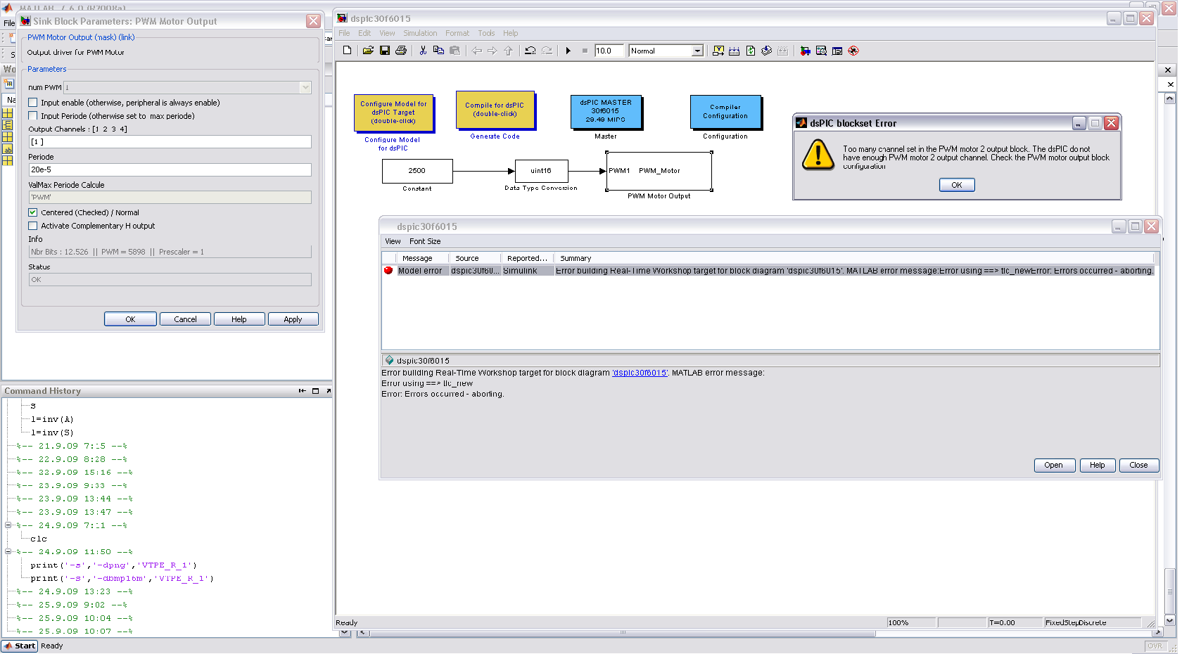

I have a problem with setting of processor type dsPIC30f6015. I can't set PWM motor output. I don't know how this problem removes. I placed print screen of this error at attachment. Then I would like asking you a possibility to set-up of dead time on PWM. I don't find this options in setting of PWM motor output block. I used R2008a version of Matlab. Thanks for your help.

Hi Jirka,
Thanks for the screen shoot.
This seems to be a bug from the blockset since the error message talk about PWM motor 2 peripheral, but the PWM motor dialog is set on PWM motor 1 !
Thus, I'll try to look at this soon. Could you upload your simulink .mdl file, It will help to track that bug.
For the dead time, I did not implemented it yet as I usually use this block just for generating PWM, not for motor control. I will try to have a look within few weeks. If you have any suggestion on how you want to have it implemented (as a constant set in the dialog box (best I think), as a block input ?)

Thanks for answer. I upload the mdl file as you required.
For the dead time, I don't have special requirement. I think that it implement as constant set in the dialog box is good.

Hi Jirka,
I compiled successfully this model on my system without doing anything particular.
Could you try to download the latest blockset version and test it again ?
Let me know if you still get the error.

I reinstall blockset for dspic and now it is all right. Thank you for help.
Now I waiting only on setting of deat time so I can try to control BLDC motor. Could you give know when you'll have complete setting for dead time?

Hi Jirka
I implemented the Dead time on the PWM motor peripheral.
Please test the new blockset version and let me know if the way it is implemented is usefull for BLDC motor control.

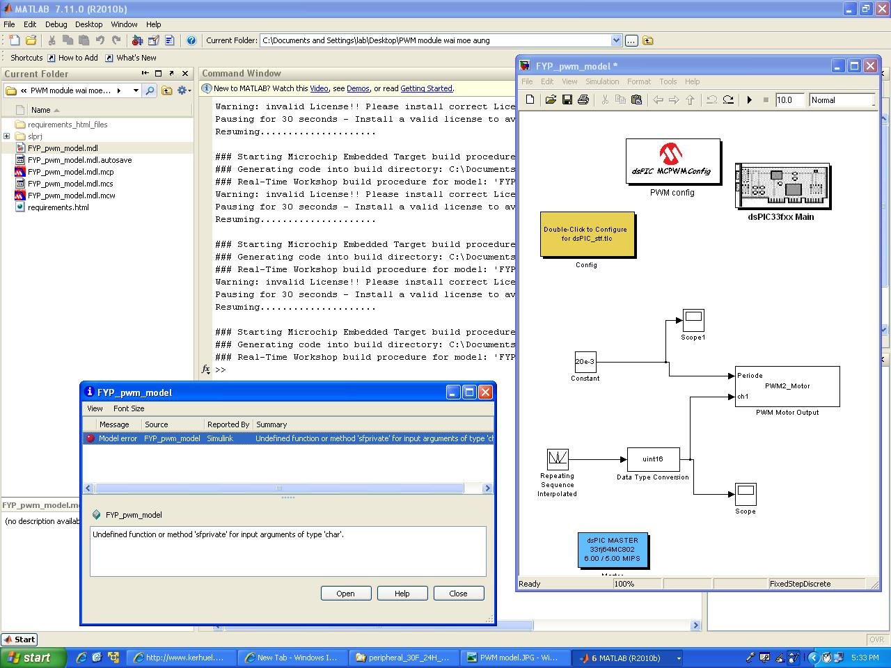

hi lubin...jirka wrote:Hi Lubin,
i have a smilar project with the above but i got another error showing this erro for PWM.. please advice me .. i really need help ..i did attach the error screem shot and the .mdl fine for your red.. hope u will help me
regards
William

i will be using with dsPIC33fJ64MC802 and microstick .
