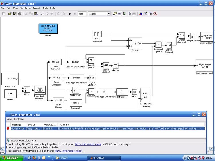

I create a model that use Fuzzy Logic Controller block, and when I try build show this error:
Error building Real-Time Workshop target for block diagram 'fuzzy_stepmotor_casa'. MATLAB error message:
Error using ==> genMakefileAndBuild at 1070
Error(s) encountered while building model "fuzzy_stepmotor_casa".
I attach the model, the FIS file and the error for help in analisys.
I need a help urgently, Thanks.
Alan

Re: Error building dsPIC30F3012 with Fuzzy
Hi again,
I found the problem, my model use the 3036 bytes of data memory and the dspic 30f3012 has only 2048 bytes.
Now I wanna know if the EEPROM memory(1024 bytes) can be used like RAM, to data memory, and how I use it?
Thanks
Alan
Thanks
Alan
Hi Alan,
It is not possible to replace RAM by EEPROM.
however, you may try to activate simulink optimization, try to check the box "inline parameters". This may save a lot of RAM memory.
