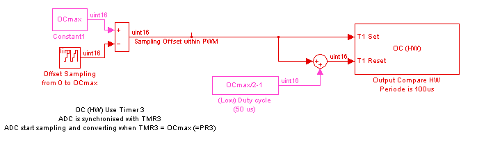

Sorry for bothering you again.
I have read the block page many times, still I cannot get what I want.
Attached is a graph got from the example of Hyper Sampling.
Could you explain how the duty cycle is decided and why there is a "+" between the set and reset inputs?
Thanks very much.
Quan
Thanks very much.
Quan

Hi Quan,
I respond quicky, sorry if there are imprecision.
OC works with a counter. For a given periode (set within the block) the counter will count from 0 to a number, let say it is 1000 here, this number is given in OCmax (it depends on your quartz).
- The ADC starts conversion when the counter is reset, ie, goes from 1000 to 0.
- The OC output is set to 1 when the counter reach the Tset value.
- The OC output is set to 0 when the counter reach the Treset value.
For example,
- if Tset value 250 and Treset value is 350, you will get a PWM duty cycle of 10% on the OC output. ADC will starts conversion while the OC output is 0
- if Tset value 950 and Treset value is 50, you will also get a PWM duty cycle of 10% on the OC output. ADC will starts conversion while the OC output is 1
