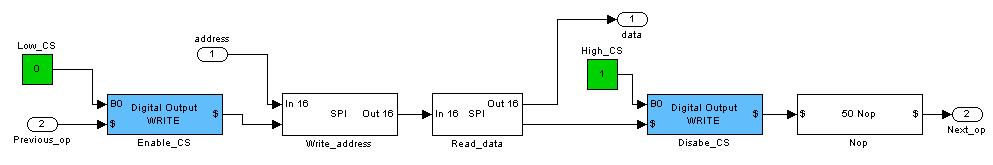

In fact I use Nop blocks for SPI communication,in order to respect waiting delays that are imposed. For 4.00 MIPS, when I put a block of 40 Nop (10 µs) between two SPI readings, delays are not taken into account when running the model on my dsPIC33. On the other hand, it does work fine when I use a C function call block that calls the function Delay(int), provided by Mirochip.
I don't understand why Nop blocks are not taken into account by the dsPIC. I join you a part of the model in order to illustrate the use of a Nop block.

Re: Problem with Nop blocks
Hi Laurent,
That is strange as I use the nop function and it seems to work.
Could you post the .mdl file please ?
Did you loocked in the generated C file ?
Perhaps the compiler optimisation configuration removes nop instruction ?
