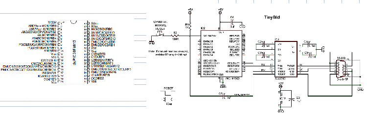

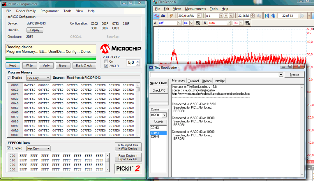

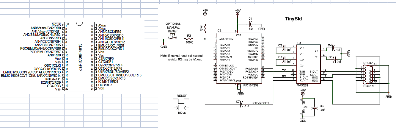

Therefor, you can find a screenprint of the GUI from Pickit2 and a screenprint from the max232 circuit.
Casparus
circuit max232 to dspic30
screenprint GUI Pickit2 and GUI TinyBld

I connected:
pin 11 (TX) of the max232 with pin 28 of the pic (pin layout see image from yesterday) and
pin 12 (RX) of the max232 with pin 27 of the pic.

I do not see errors on the Rx-Tx connections.
Using USB to Serial converter is not a problem.
To test your hardware, I would advise to create a simple schematic for you dsPIC with simulink, compile it and load it using your usual programmer (ICD2). You can use the windows HyperTerminal to check that you PC can transmit/receive data with the dsPIC through UART.
Anyway, you may have a serious problem because you do not use quartz: dsPIC Internal RC oscillator is usually not precise enough (and may vary over time) for UART set-up, except if you use the microchip system to auto calibrates the UART (see UART doc, not supported in the blockset).
