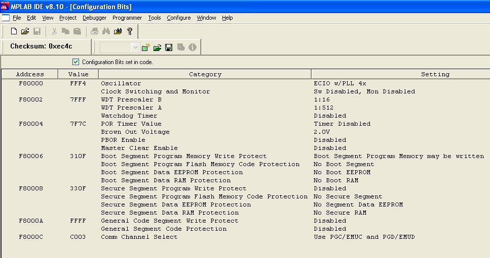

You could have a look on the configurations bits once the .hex is loaded in MPLAB. (Configure ==> Configuration bits)

I still get the same error. And I have checked the config bits, the oscillator is set incorrect, I set XT mode but it's ECIO w/PLL. I use 30f6014A device, MTALB 2007b, 0.99a toolbox, C 30 3.11b compiler and MPLAB V8.1.

I know the reason. Your toolbox support 30f6014 correctly, may be not for 30f6014A. I found that the setups of config bits are different for 30f6014 and 30f6014A in MPLAB. They are not compatible. So can you add the support of 30f6014A individually? I think this also might be the solution for my problem of the controller design which I mentioned before.Thanks very much.

The following chips were added : 30f6010 ; 30f6011A ; 30f6012A ; 30f6013A ; 30f6014A. Theses changes will be available in the next release version (0.99b)
It solved this problem.
