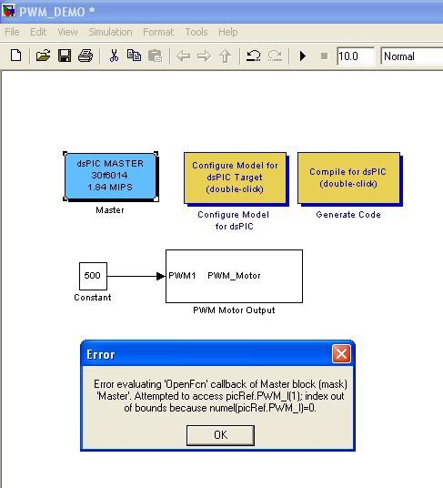

It seems I have a similar problem.Once I add the PWM bolckset to simulink model, the 'master' block couldn't be opened. The pic attached shows the error info. Also same error appears during compiling.
cheers
New Picture.jpg (33.64 KiB) Viewed 21672 times

I have upgraded to V0.99a for R2007b and R2006a, but the problem still exist, the picture shows the error info for R2007b
New Picture.jpg (38.49 KiB) Viewed 21623 times

Post by LubinKerhuel » Thu Oct 30, 2008 1:34 pm
Hi Gladiac,
I check the dsPIC you are using 30f6014, it has no PWM motor peripheral ! I will try to update the error message to make it more clear.
You can generate PWM signal using the Output Compare block. 30f6014 has 8 OC channels capable to generate a PWM signal.

Thanks! The problem seems to be caused by myself. I just muddled up your 'PWM blockset' with the PWM mode of OC module. So your 'PWM blockset' works for MCPWM module. Thanks again for your help.
