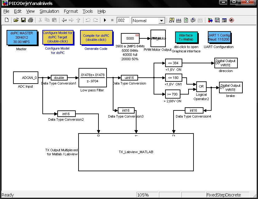

- PID20ejeYanalnivels.mdl

Re: Error using ==> rs232gui
Hi Jose Luis,
You model has an original blocks disposition. I'll probably get inspired from it. Anyway, I do not see errors.
When does the error appears ? at the connexion time or when you click on start ? Let me know...
If it appears when you click on start, there may be problems with bauds. You computer's serial port may be not tolerant enough to baud errors.
The % error of the UART@115200 is 1.7%. It should be Ok in most case. Anyway, you may try using a 57600 bauds that will have an negative error (-1.3%). bauds of 38400 will also offer even less error...
The problem may come from the electronic max232 like level translator.
You may try to receive data as raw datas (button raw). But as the data will not be demultiplexed, you will get a nice mess...
I do not know if that will help so much. I have hardly no problem with this interface. My feeling is that it is quite robust now.
