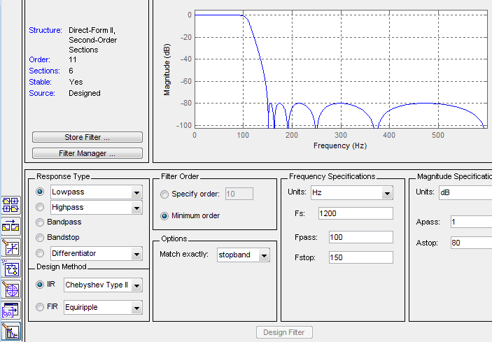

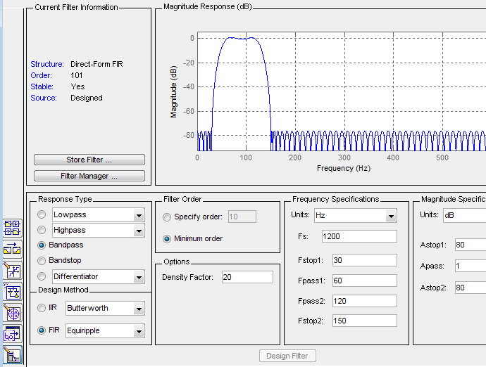

As you see, I have uploaded some working filters, designed in the FDATool, with their properties in the way I designed them in the FDATool.
