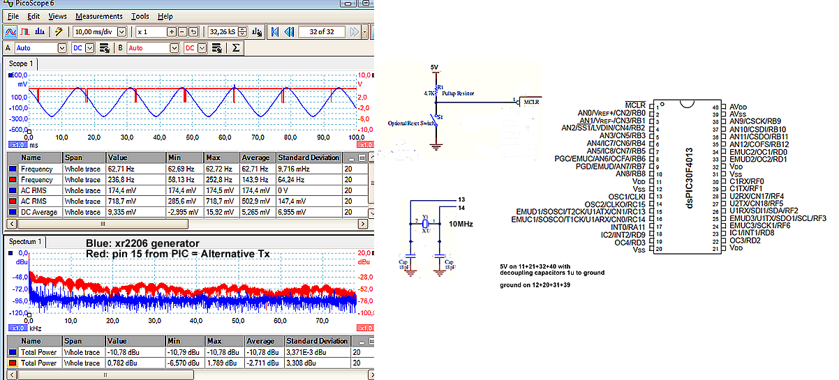

I am trying to run a dsPIC30f4013 for the first time, together with a function generator. In the image attachment you see a screenprint from my scope and the pinlayout of the pic4013.

Next, I write the hex file with a Pickit2 in the pic4013. Then I connect the funtion generator with the pic. As you can see in the printscreen of the scope, there is no correlation between the frequency of the generator and the pic4013. The only thing is, when I change the frequency of the generator the frequency of the pic is changing, but it seems to be without any correlation.
Please, can you provide me with some helpful hints?

As far as I understand, you want to make a digital LP filter at 148Hz. A very first remark is from a theoretical signal processing point of view: The sampling time (model step time) is 1/300s. Thus, all frequency above 150Hz will recopy themselves inside the 0-150Hz band creating aliasing. You should use an analog filter to take out all frequency above 150Hz before the A/D conversion take place.
Anyway, there are few problems with your model:
*30f4013 has a 12 bit ADC. Thus, the first uint8 Data type conversion block after the ADC will certainly saturate.
*about the LP filter: all coefficients are stored in double format (that is a good point because their value look like 0.014552788094050004). Thus the multiplications are done in double. Thus, there is no reason to make the output a uint8 value. The output of the first calculation could vary between 0 and 4 (0.014*255) only. There is a major problem with fixed point calculation here.
*Some coefficient are negative ==> Major problem when result is stored in an unsigned variable.
You may consider using a IIR filter that usually give good filtering results with fewer taps than a FIR filters. (That may allow leaving all calculation in double inside the dsPIC).
I would recommend to do simulation test (start with the file attached). Start using double calculation only ; then, try to use the fixed point tools to make the calculation efficient on the dsPIC.

* Same problems remains: filtering at 145Hz with a sampling rate at 300Hz is a non sense. (See sampling theory http://en.wikipedia.org/wiki/Nyquist%E2 ... ng_theorem)
* Output visualisation: your signal is likely to be greater than 255 (ADC output value is within a 10 or 12 bit range and positive only). You should output your signal via a 16 bit variable. I suggest using the TX_Labview_MATLAB block to send the data, and to see your data on your PC with the rs232GUI interface that comes with the dsPIC blockset.
* The designed filter is a FIR with many taps. Calculation are in double, the number or instruction of your dsPIC is not that high (2.5MIPS ?). You should make sure that the dsPIC has time to make the calculation within the defined time step (3.3ms, hopefully that's a large time step). Use the Overload Flag Port option available on the master block or the Calculus Time Step block
The filter calculation itself may work well (from your simulation). There may be problems at the output level and in the real time calculation.
