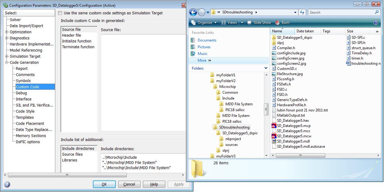

The attached screen image shows the configuration parameters and where I enter the names of the custom c files. Instead of "Simulation Target" they might also go under "Code Generation." Please verify--do I have it right? Does it work just as well to put the file names under"Code Generation?" Regards, John

Hi John,
That's not correct.
File reference must be included into "Include list of additional". Otherwise, simulink will just add the name on the file within the generated code, that would create an error!
Then, the files should be included into the Code Generation panel. Not the Simulation Target (did not notice this earlier)
That's not correct.

Like this?

Correct.
you might also add the folder where they are in the "include directory" box if the compiler did not find theses files.
